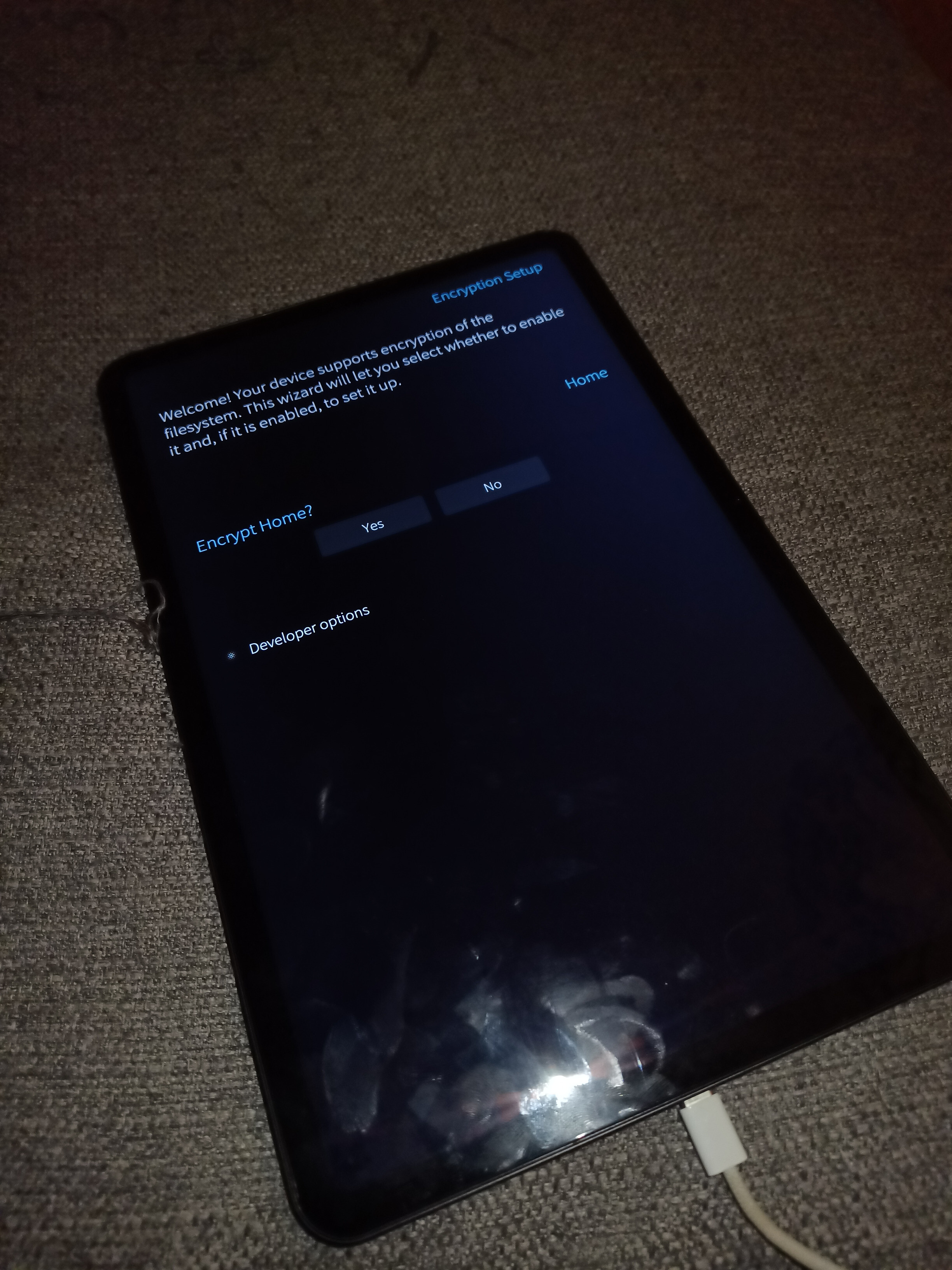

Volla Tablet has the Multi Boot Option now. Nice Device on the hardware side, but totally worse on software side. The only reason I didn’t sell it after a week is that I’d like to use it with Sailfish OS (and only Sailfish OS, no Multi Boot).
So I’d be happy if there are some news on SFOS on Volla Tablet…
Hi Cryx,
I assume you saw this a week or so ago?
Not yet, but Piggz is working on it.
