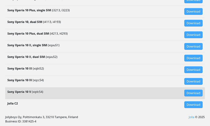

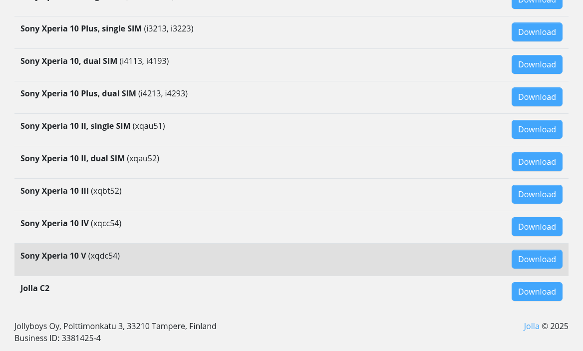

I have a C2 image listed on shop.jolla.com - presumably that is available for all?

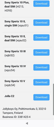

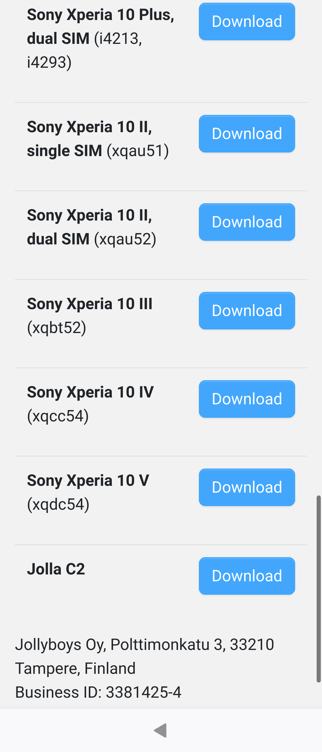

I checked this right now and got offered to download a C2 flashing image. I have some licenced devices but never ordered a C2. It seems to be available for all.
And even if you bought a C2 it shows up in store :stuck_out_tongue_winking_eye:
