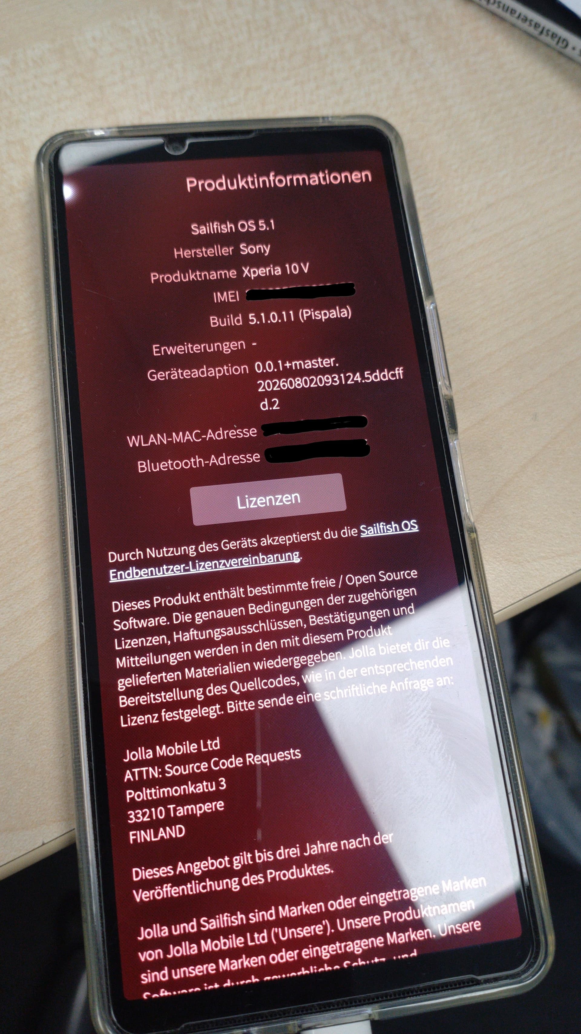

Thank you so much for your work.
I was able to successfully flash your image onto my Xperia 10 V today.
Everything works as @juz described. :smiley:
