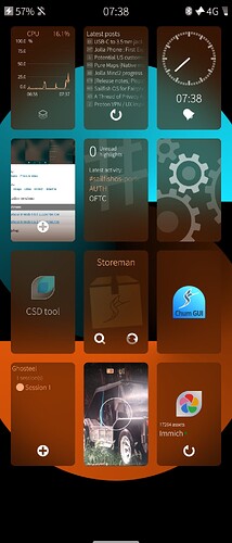

So, for the last month and a bit I have been working on a Lineage22.2 based SFOS 5.1.0.11 port for the Xperia 10 IV (pdx225). Note that my phone is a XQ-CC72. YMMV if you have an XQ-CC54 but it should still work the same. Update: @mettska was successful installing on their XQ-CC54.

  • Camera (just main rear camera for now, I was so happy with that I haven’t bothered looking into getting the rest going. Photo + video works)

  • Sensors (sensorfwd seems to require restarting after first boot, you can just reboot the device or run devel-su systemctl restart sensorfwd)

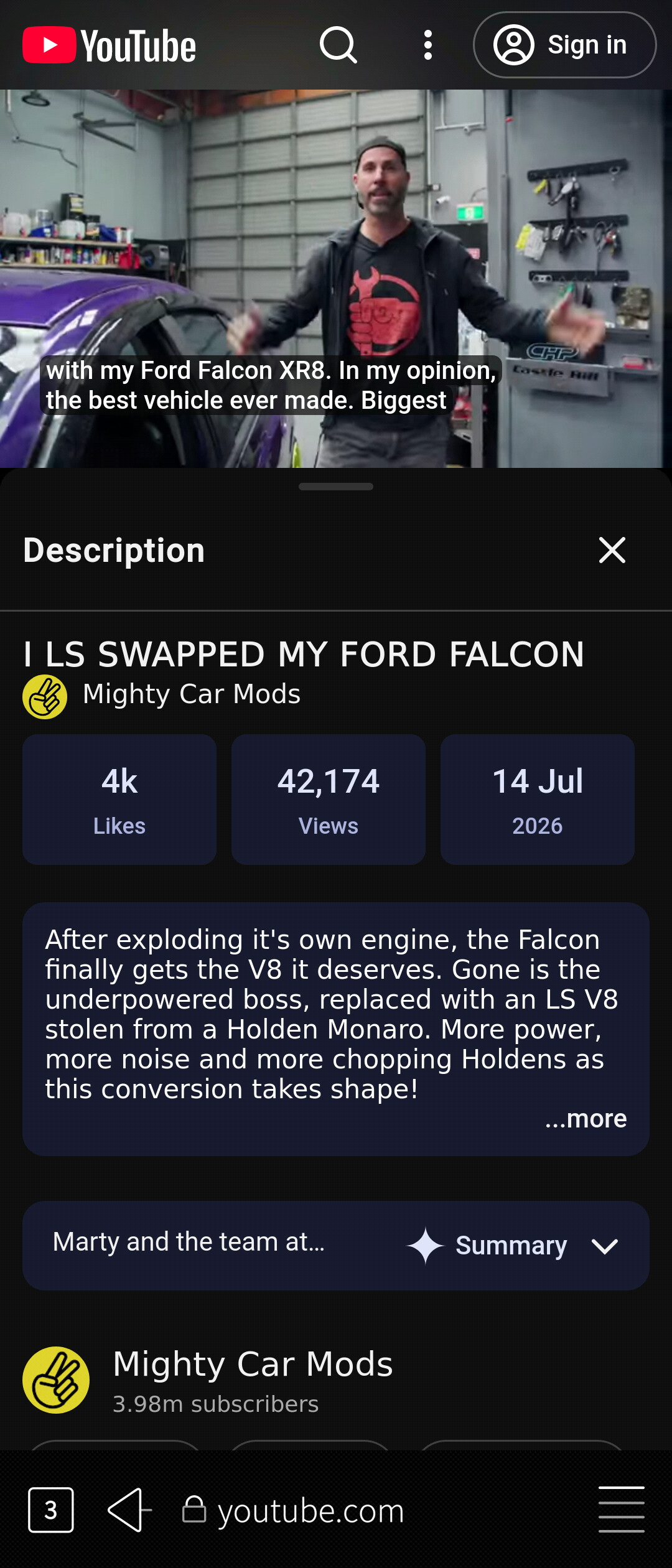

  • Youtube playback in the browser (seems intermittent / related to resolution)

Oh? I sat down for lunch today and thought while I eat I’ll investigate the youtube bug - I think I got it working!
