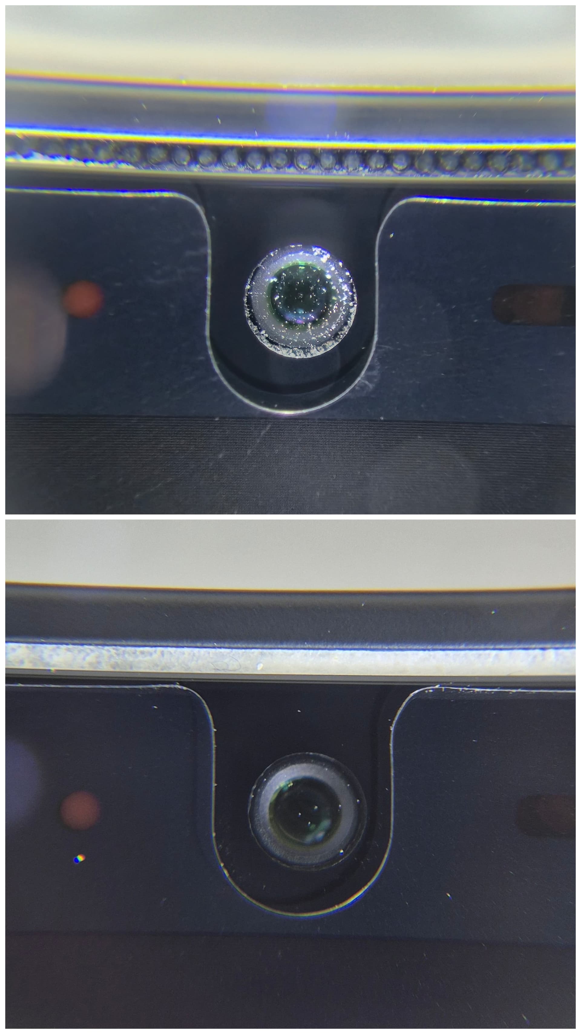

The front camera module is sealed with a rubber sealing to the front glass, and the sealing needs to sit properly in its place and slightly ā€œsqueezeā€ precisely to make it tight with the front glass. In the affected units, this very sealing either has been completely missing or it has been installed improperly, due to a manufacturing assembly error, which can be concluded the root cause for this unfortunate issue.
To fix the issue we have changed the assembly order of the rubber sealing and added a testing step in the manufacturing process to ensure the rubber sealing is not missing and that it sits properly in its place.
Due to the mechanical structure of the front camera area, and that the proper placing of the seal requires special precision assembly, the fix IS NOT feasible for DIY and we DO NOT recommend experimenting with it. This also means that we will replace the complete unit in question.

To verify the applied changes are effective our CTO defined a specific Flour Dust Test in which an excessive amount of very fine grade common wheat flour is exposed (literally baked :slight_smile:) to the unit. The test on purpose exceeds heavily the normal usage and IP4* test conditions. Please see below a comparison of two units after the same flour dust test:
  • unit with the seal improperly in place
  • unit where the seal is properly seated in its place
