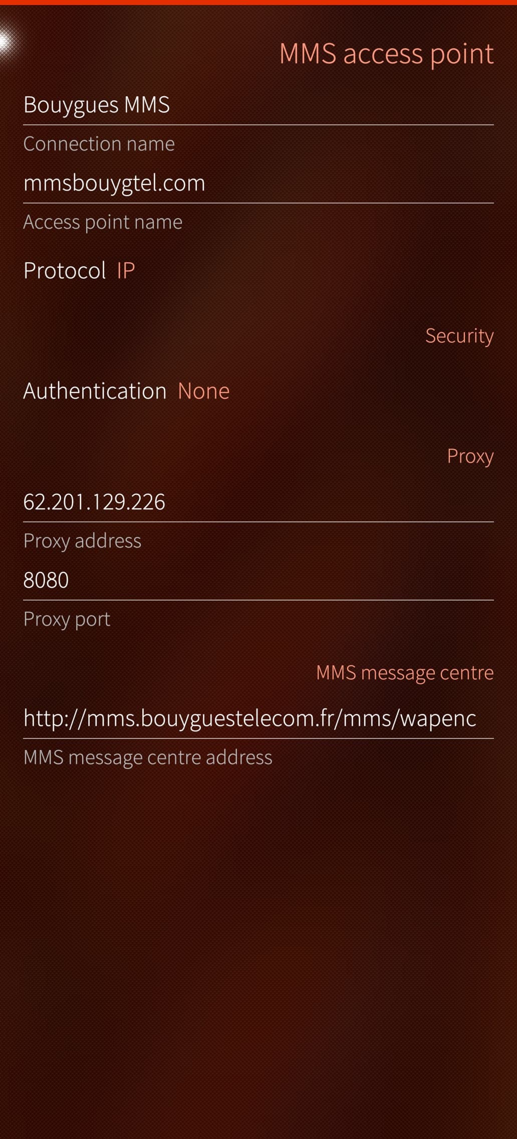

I had the pb, solved for me with the following parameters for MMS Access Point :
APN : mmsbouygtel.com
Protocol : Mixte
Authentication : None
Proxy Address : Leave empty
Proxy Port : Leave empty
MMS address center : http://mms.bouyguestelecom.fr/mms/wapenc

Thanks ndaguenet, your settings make MMS work on my Sailfish OS 4.2.0.21 Xperia XA2 :slight_smile:

@ndaguenet: if I understand correctly the values you gave in your earlier post above are working well for you? Could I ask where you got these values from please?

The value were a mix of personal tests and information from the internet. They still works fine for me even if I have a small doubt about receiving/sending MMS when Wifi is active, it seems to work better when de activating wifi.

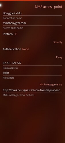

Unfortunately for me, neither the original Jolla values nor the proposed versions in this thread works for me. MMS are not going through.
Xperia 10II
SFOS 4.6
B&you

On my C2 (5.0.0.43), this solution work : MMS setting for Bouygues Telecom and co (Fr)
In case anyone is still troubled by this, these are the settings that worked for me (Jolla phone 2026):
