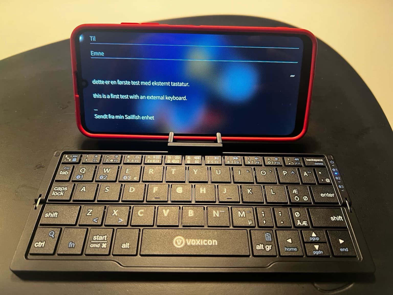

I use my C2 with a foldable Bluetooth keyboard once in a while:

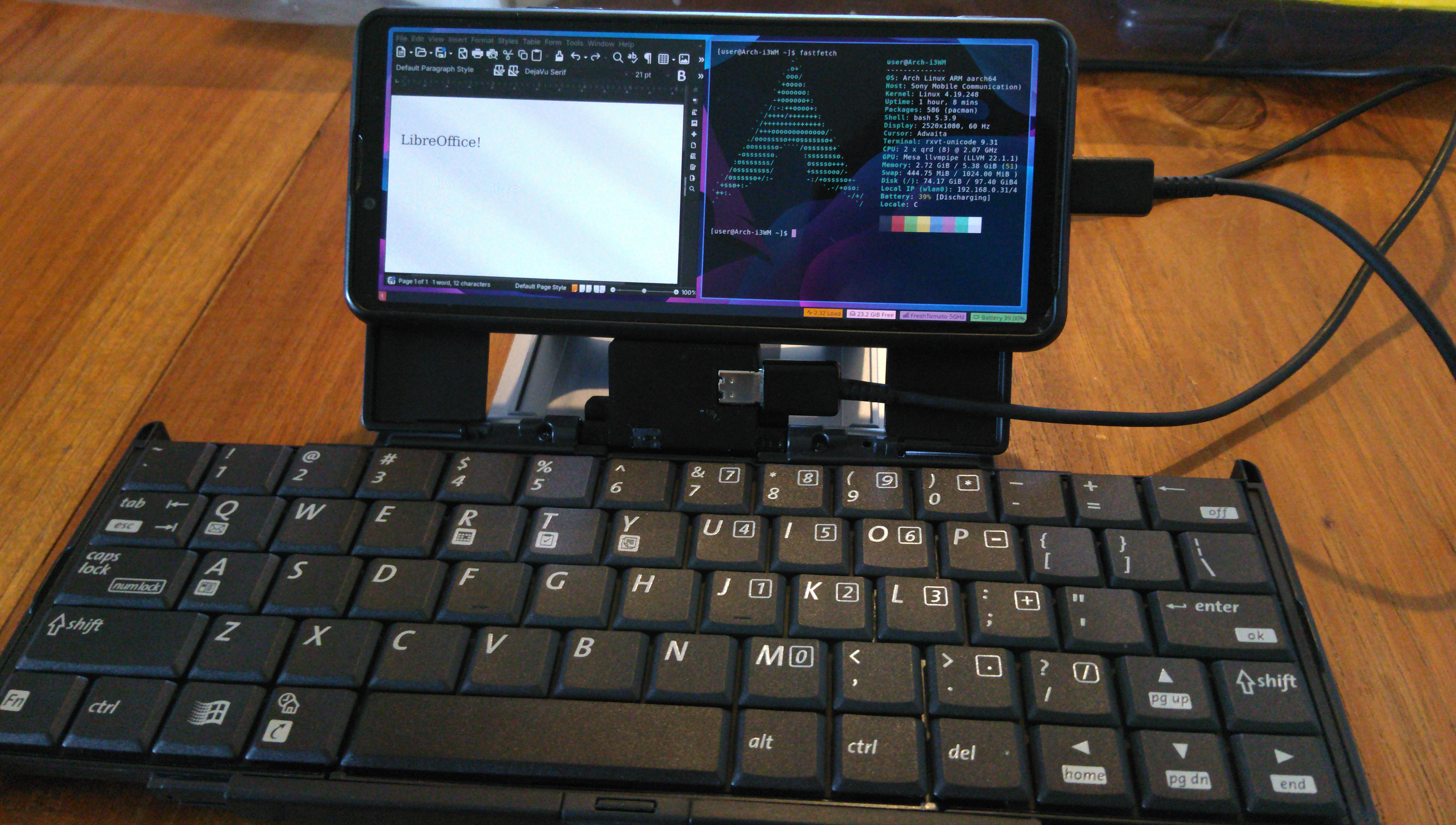

Finally, an occasion to show off my HP G750 PDA keyboard with Bluetooth module (which only works wired on SFOS due to Bluetooth LE issues)
Take what ever he says with a grain of salt. He is a known troll on these forums, who will randomly appear to spread FUD.
