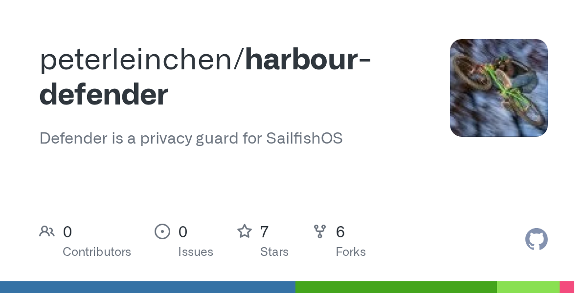

Defender was (and is) a very nice and handy tool. And it eases ad blocking and adds some privacy measures. All kudos to nodevel!
Unfortunately it was not maintained anymore (but now is again) and even worse it caused encrypted devices to stop booting (it could be resolved by using recovery image and deinstalling ‘rpm -e harbour-defender’ (or editing path unit manually).
I could not (and still cannot) understand that systemd can be so bold to ‘support’ such situation causing full boot freezes.
It took me some efforts to grab what caused this but in the end found and solved it.
Furthermore I modified some code to handle as well nemo as defaultuser as valid GUI users.
Code is on github
