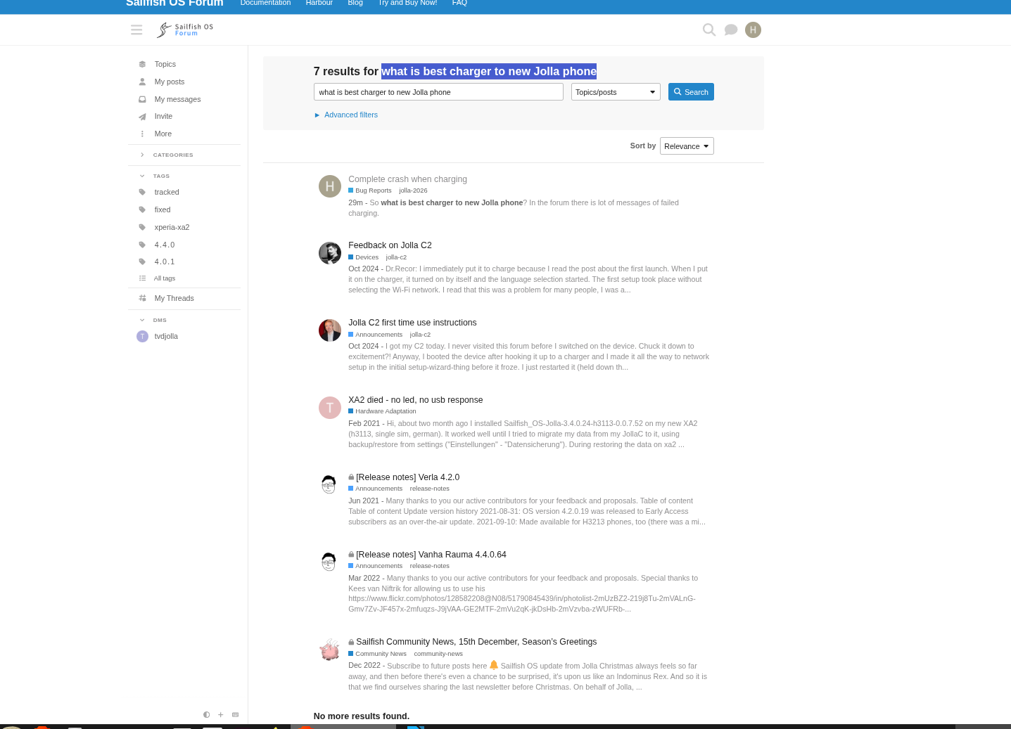

Mine also does this with one charger. Some older one. A newer ex-oneolus charger and a pd chrger work ok.
So what is best charger to new Jolla phone? In the forum there is lot of messages of failed charging.
It’s also a known issue. We need to wait that Jolla gives some conclusions about that bug.
Besides there is a topic whit that title.
Ive been using Jolla for a weekish now with overnight charging. I havent had issues yet, and I have set charge limit to 90%. Maybe that could help?
Charge limit 90% is the default iirc. I have it enabled at least.
I searched what is best charger to new Jolla phone and I got 7 answers and none of them is right.
Did you read the whole topic with that title?

I can’t read because I do not find it.
Not literal that title but here it is.
Thank you, I will read and follow that topic.
