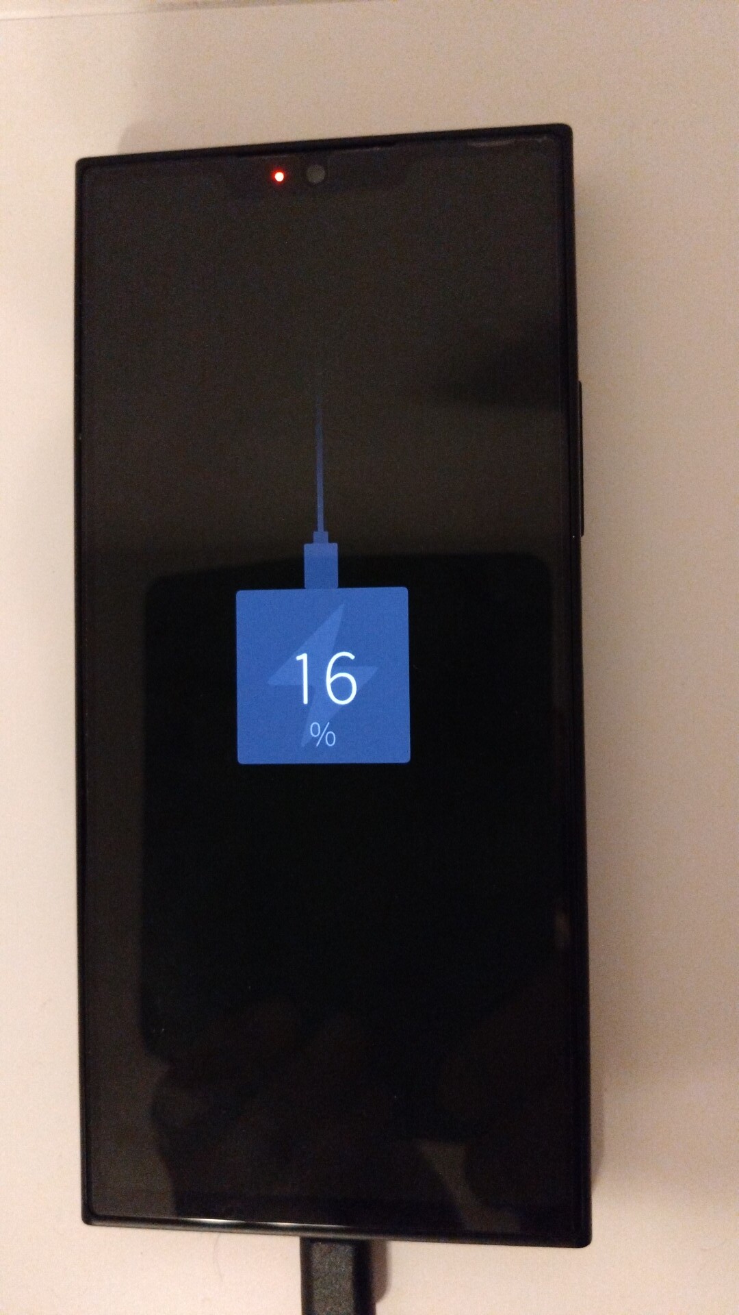

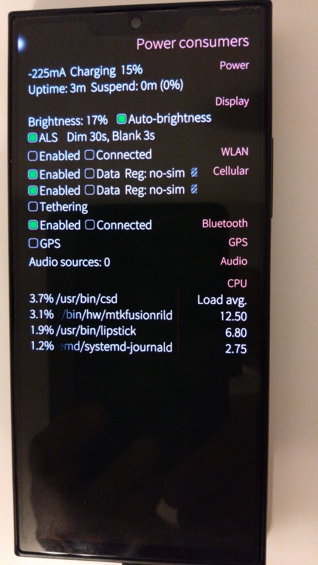

For two weeks charging worked without problems, I tried two Sony chargers, one for a Gemini PDA (1300 - 1500 mA), all worked well and without problems. Until today, 15.8.2026. Battery Buddy 4.4.0 beta 4 sent a notification when the lower limit was set to 22%, I connected the mobile phone to the charger but the current in Battery Buddy was still negative and low, even though after the release of beta 4, which also solves the minus sign when charging, I tested the application beta 4 and it worked correctly, without a sign and the current was about 1300 mA. To be sure, I also checked it in CSD, the result is the same, the mobile is in “charging” state, but the current is low (approx. 200-350 mA) with a negative sign (minus), i.e. the mobile is not actually charging.
Both the charger and the phone remained cold after an hour of connection/charging (they didn’t warm up as usual). I tried the chargers and cables on both X10II and X10IV, everything worked correctly. I blew out the socket on the phone, gently moved the cable, it didn’t help.
Mobile connected to the charger
  1. Connect the mobile phone to the charger
Charging with a current of approx. 1300 - 1500 mA
The mobile phone is in charging state (LED, status) but the current has a negative sign and has a low value (200 - 350 mA) as when discharging.
The result is the same with AAS on and off
I also tried charging with the phone turned off

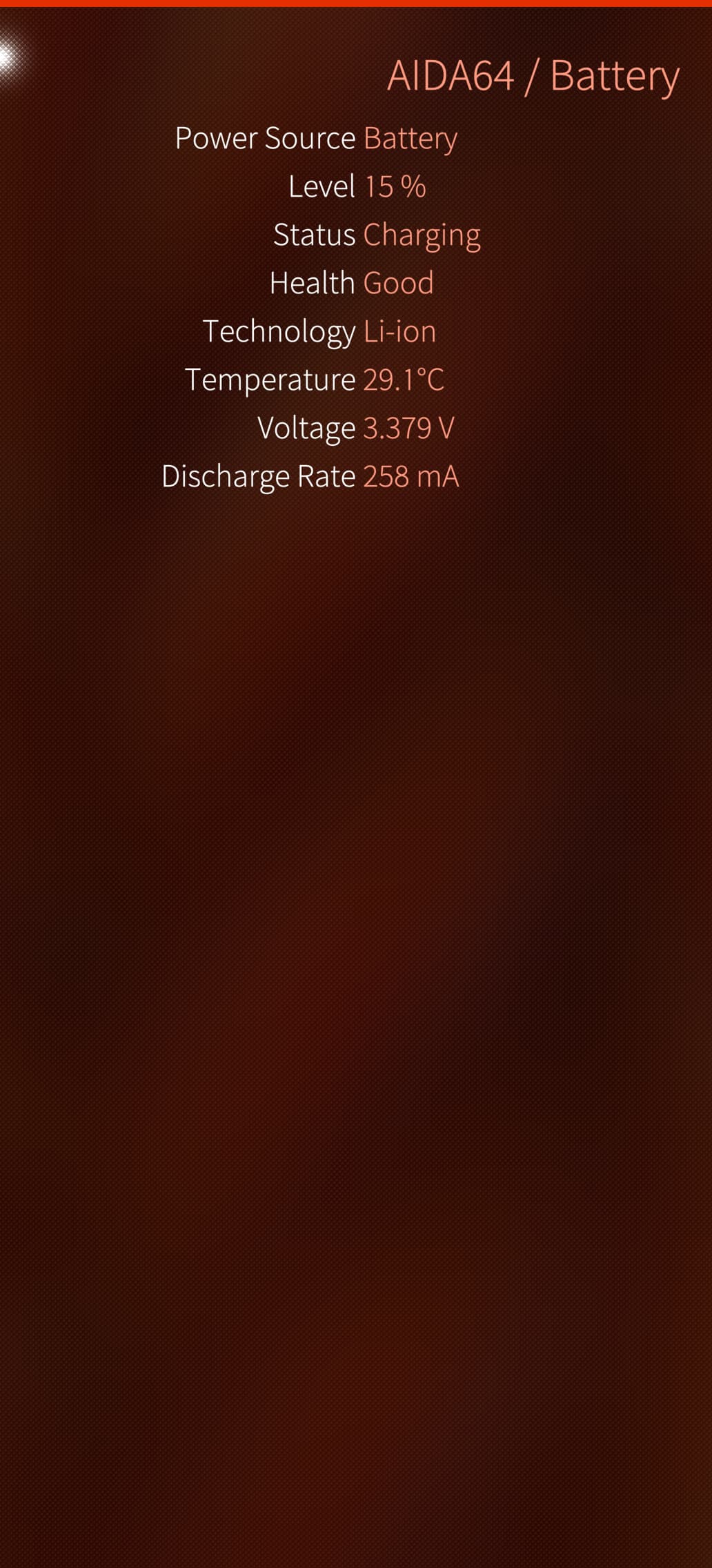

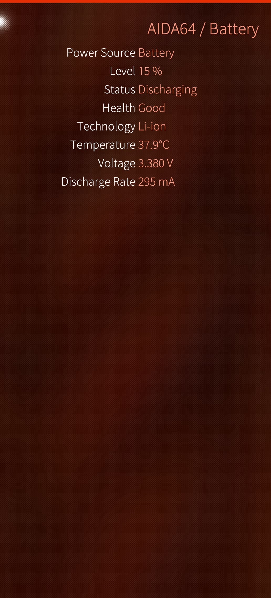

Just fishing in the dark here. Can you install AIDA64, what battery voltage does it show and what amperage is it showing when plugging in the charger? Does it change beyond idle fluctuation?
Before connecting the charger
After connecting the charger
