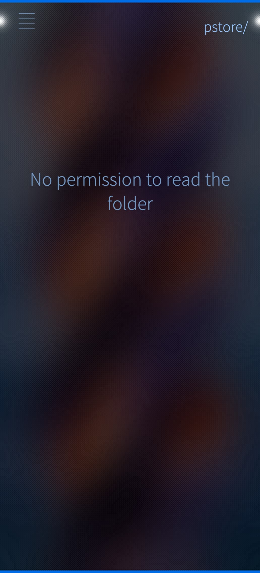

Please check if you have anything in “/sys/fs/pstore/” folder after such crash if it happens again, or if you already have something there. If you have a crash log there please send the log to me in private message, preferably compressed with gzip or some other simple packaging method.
What is easiest way to check? Tried with file browser, but it ended here
Easy way is using terminal app (which you get when you enable developer mode) and there using devel-su to get root access using the password set in developer mode settings.
