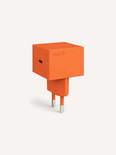

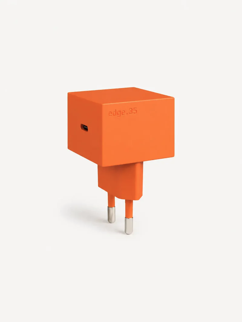

So, since any good charger will be good, why not a color match?
Unfortunately Orange 35W is out of stock.
(Accessory collab idea?)

No idea if the quality matches what their ambition level looks like, but i’m grabbing one (in black) to find out.
Inari Blue with blinking Jolla logo would create a certain appeal…
The orange one is pretty nice yes sadly its out of Stock jolla phone owners have buyed it out allready
Very nice design!

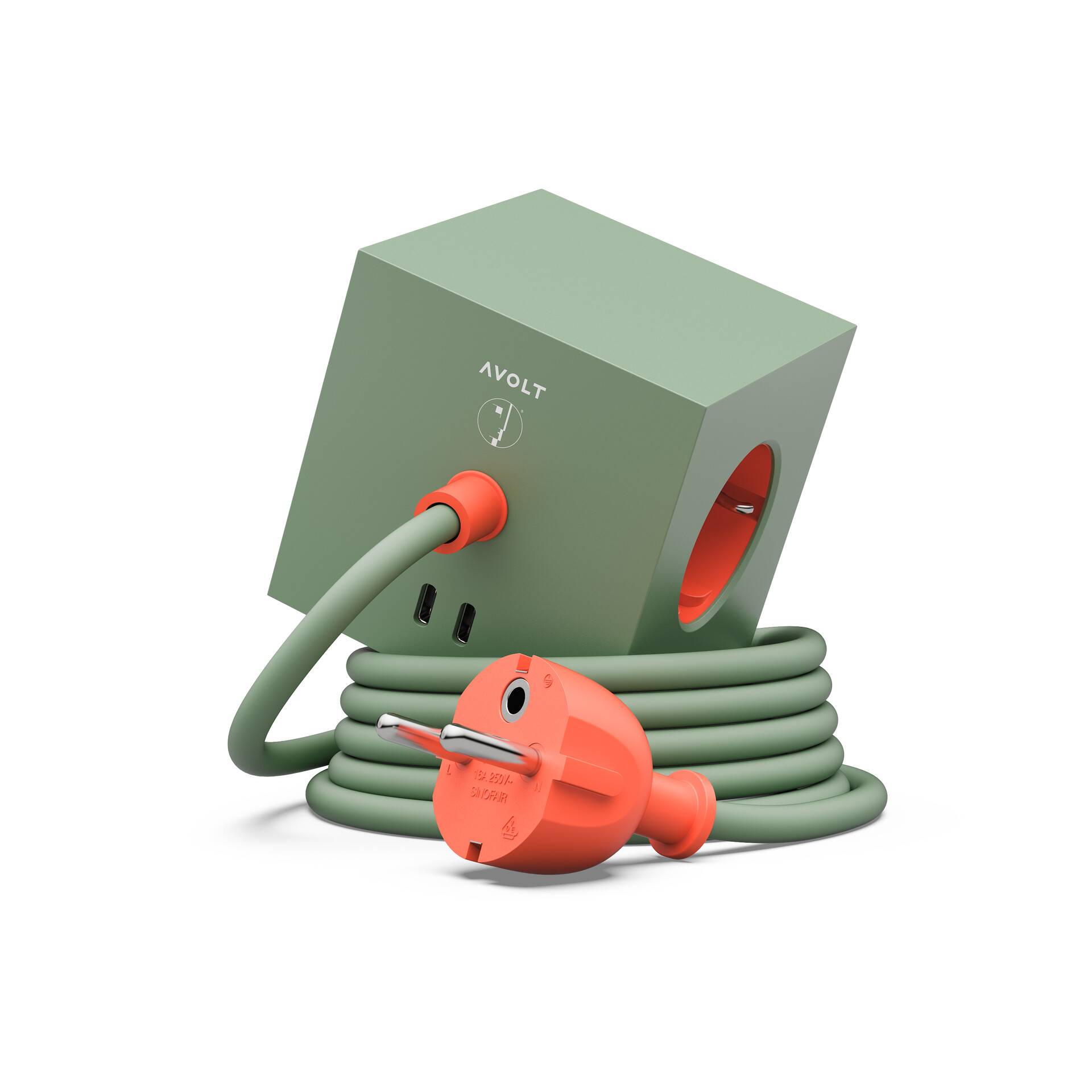

Another beautiful Swedish :sweden: design power cube is Square 1 USB-C (30W) Power Strip in Gecko Bloom – AVOLT x bauhaus-archiv
