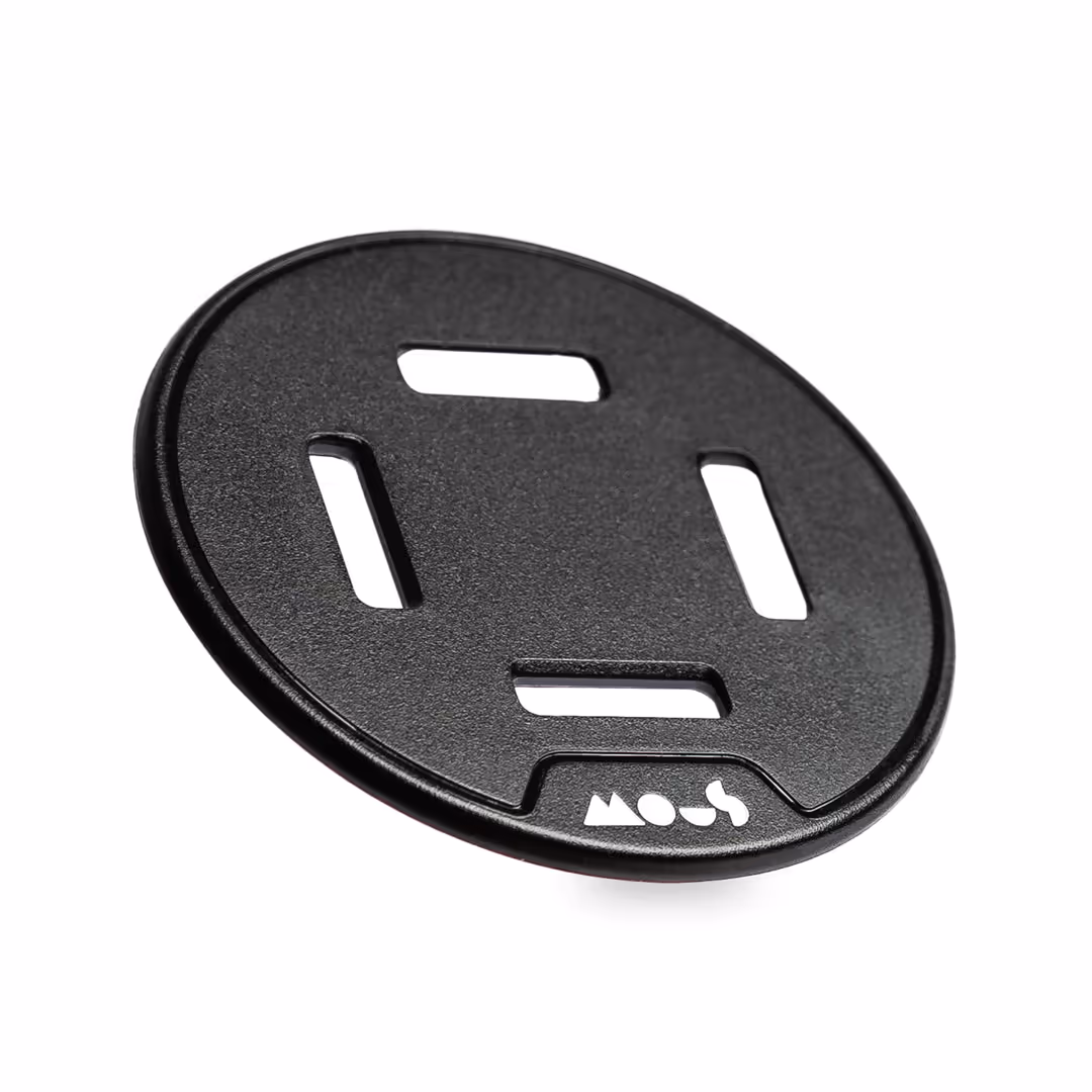

Magsafe/intralock compatible magnetic ring.
Best case: integration of mous bike fixture adapter like this one:
https://eu.mous.co/de-de/products/universal-intralock-convertor
this will allow to snap it on the bike holder :slight_smile:

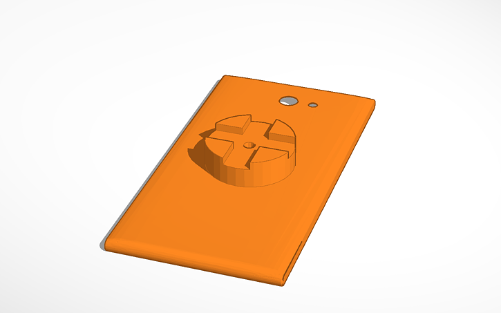

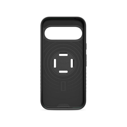

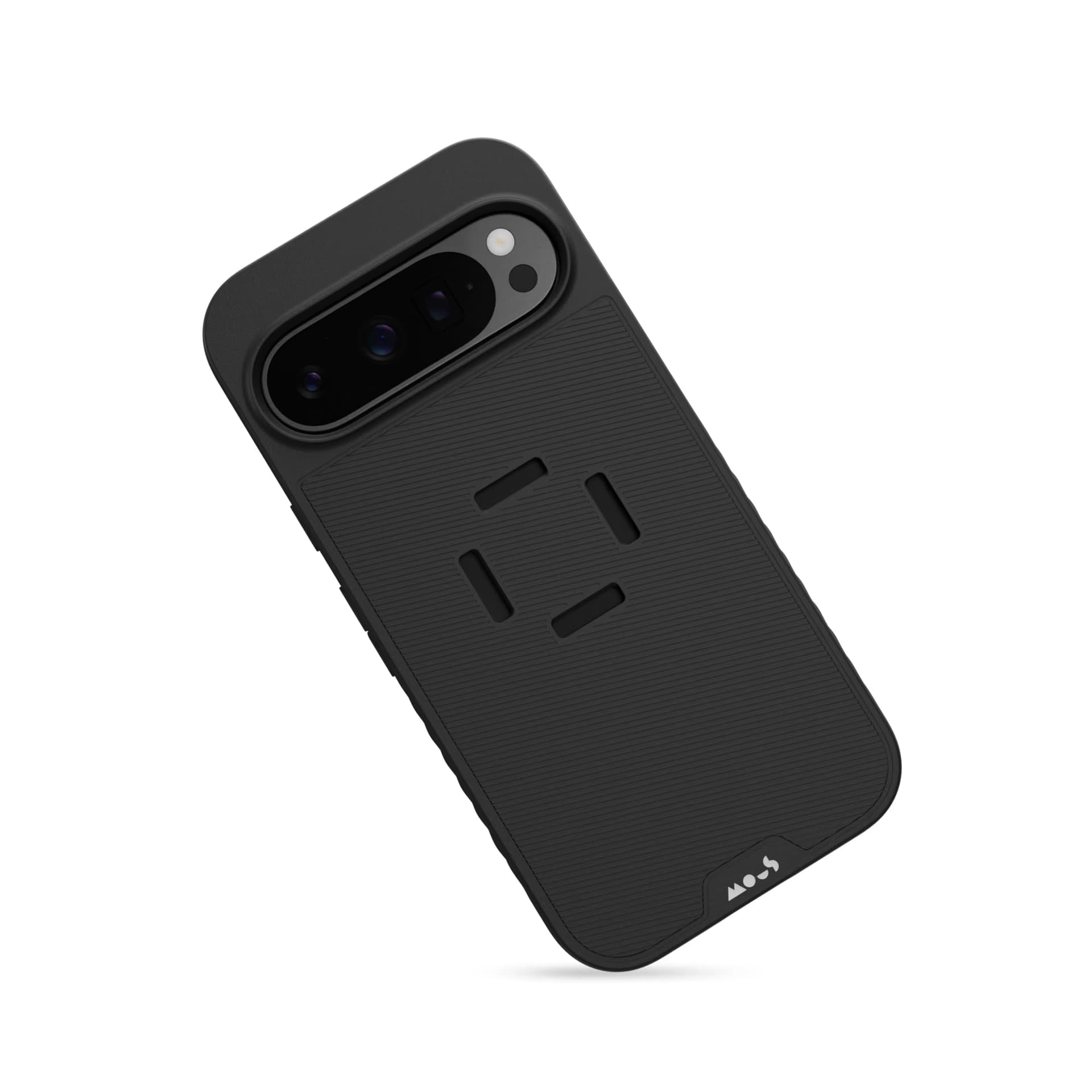

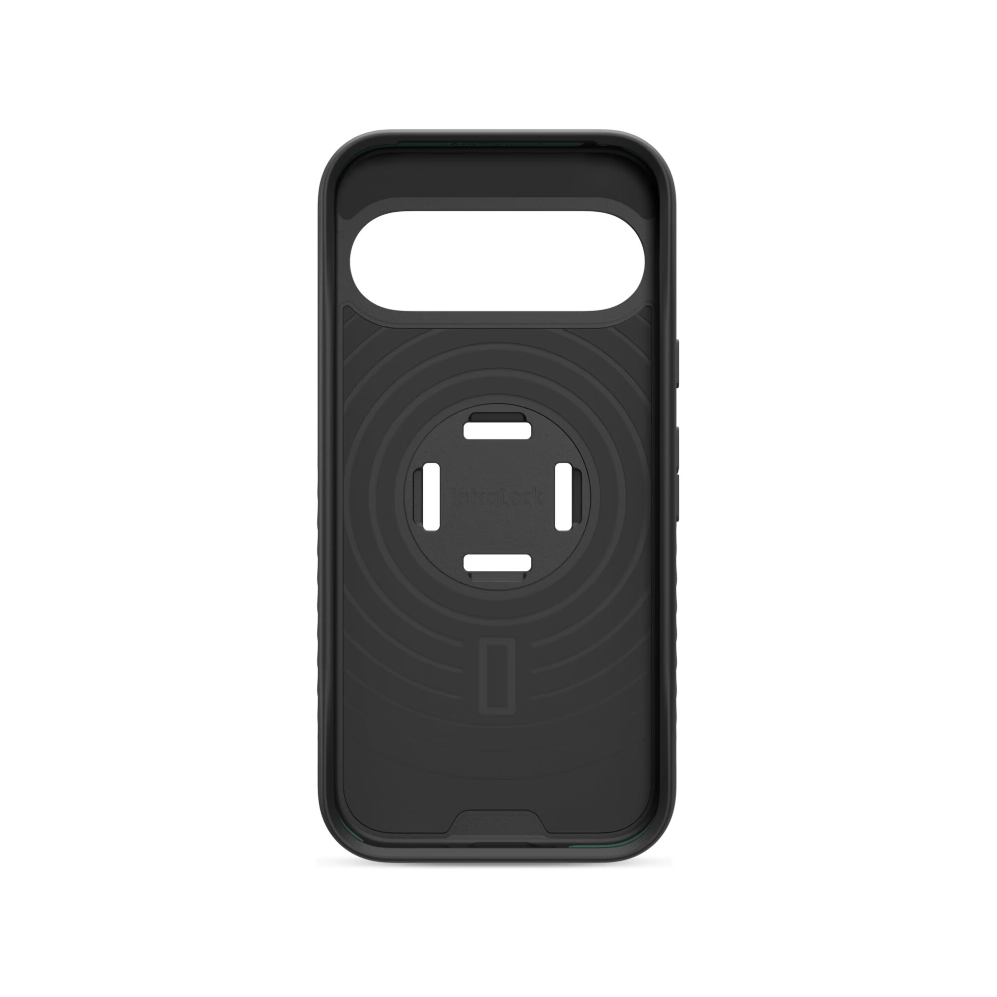

TOH horn
TOH bikemount
for the bike mount it should be another way:
  • The cover needs to be thicker, with a recess in the center to hold the Mous adapter in place.
  • this case will provide also better coverage for camera lens, and
  • If you placed the JP2 on the table, it would lie flat.
  • The extra space in the cover could be used for other purposes, such as a small battery or even a LoRa chip :wink:
Edit:
But it certainly wouldn’t be hard to make the same holes four times in the cover and insert a metal ring. Then you wouldn’t have to glue the adapter in place.
Edit 2:
