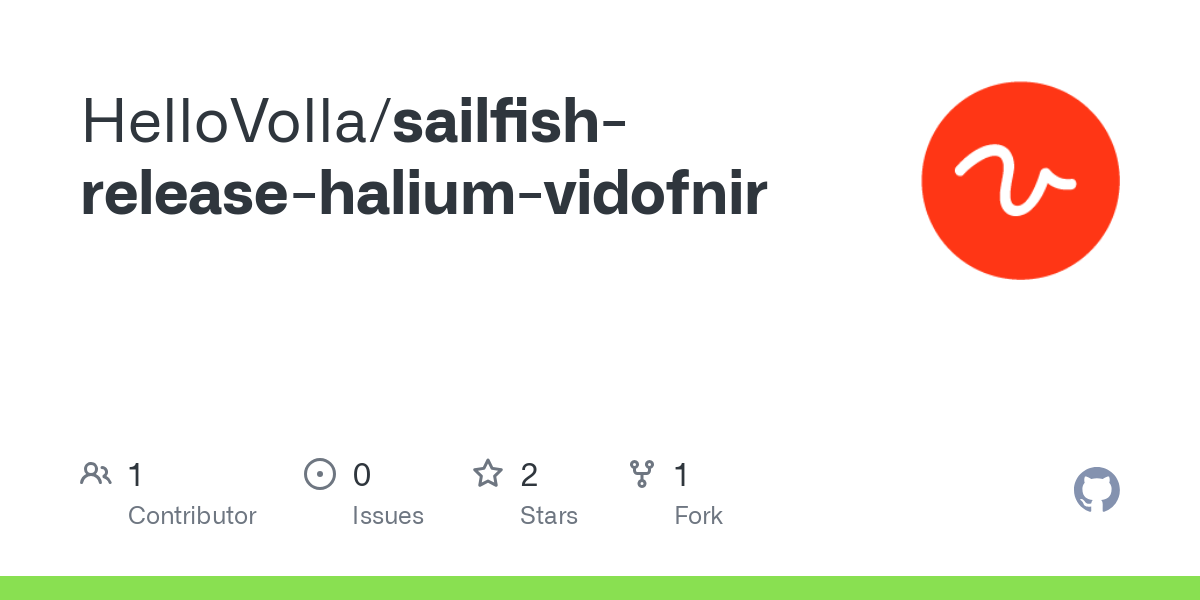

Sailfish 5.0 Images for the X23 are here
