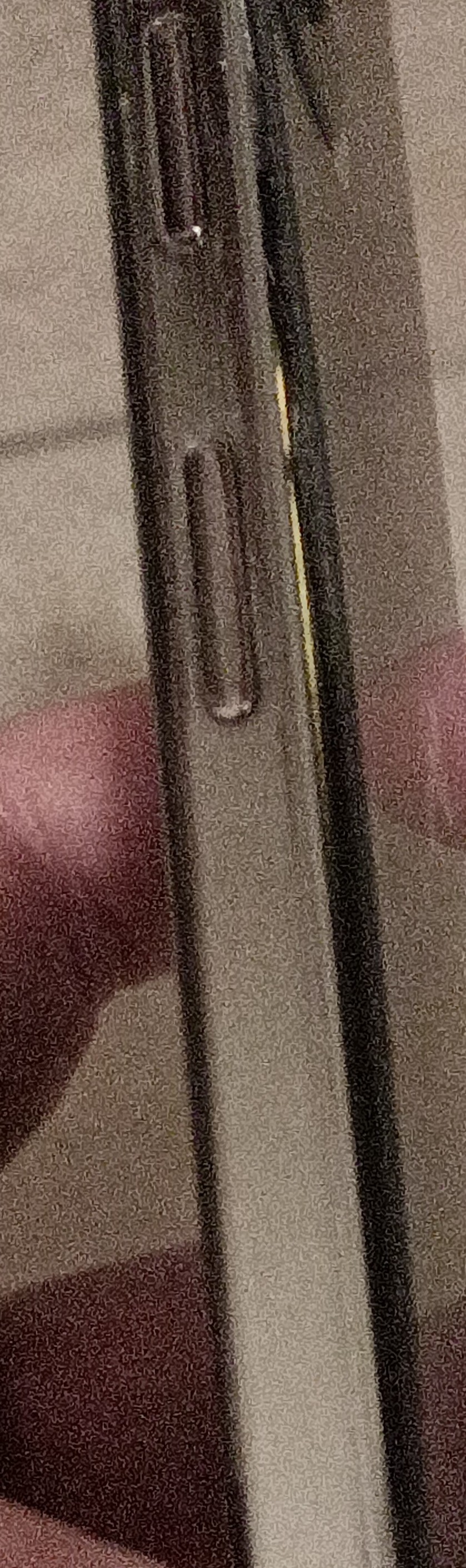

I left my Jolla C2 powered off in the drawer of my bedside table for approximately one week.
Upon attempting to use it today, the device did not power on. I connected it to the charger, assuming the battery was discharge, but it indicated a full charge (100%).
I then observed that the original silicone cover no longer adhered properly to the phone. After removing the cover, I discovered that the battery had swollen and consequently bent the rear metal panel out of shape.
Now, I will waiting for Jolla Support…

I recently had the same problem: the C2 would suddenly switch off, even though it had 100 per cent battery just a moment before.
When I switched it on, it displayed a battery percentage that seemed completely random to me.
I removed the back cover and saw that the metal back panel was warped.
I suppose it’s because the battery swelled up.
