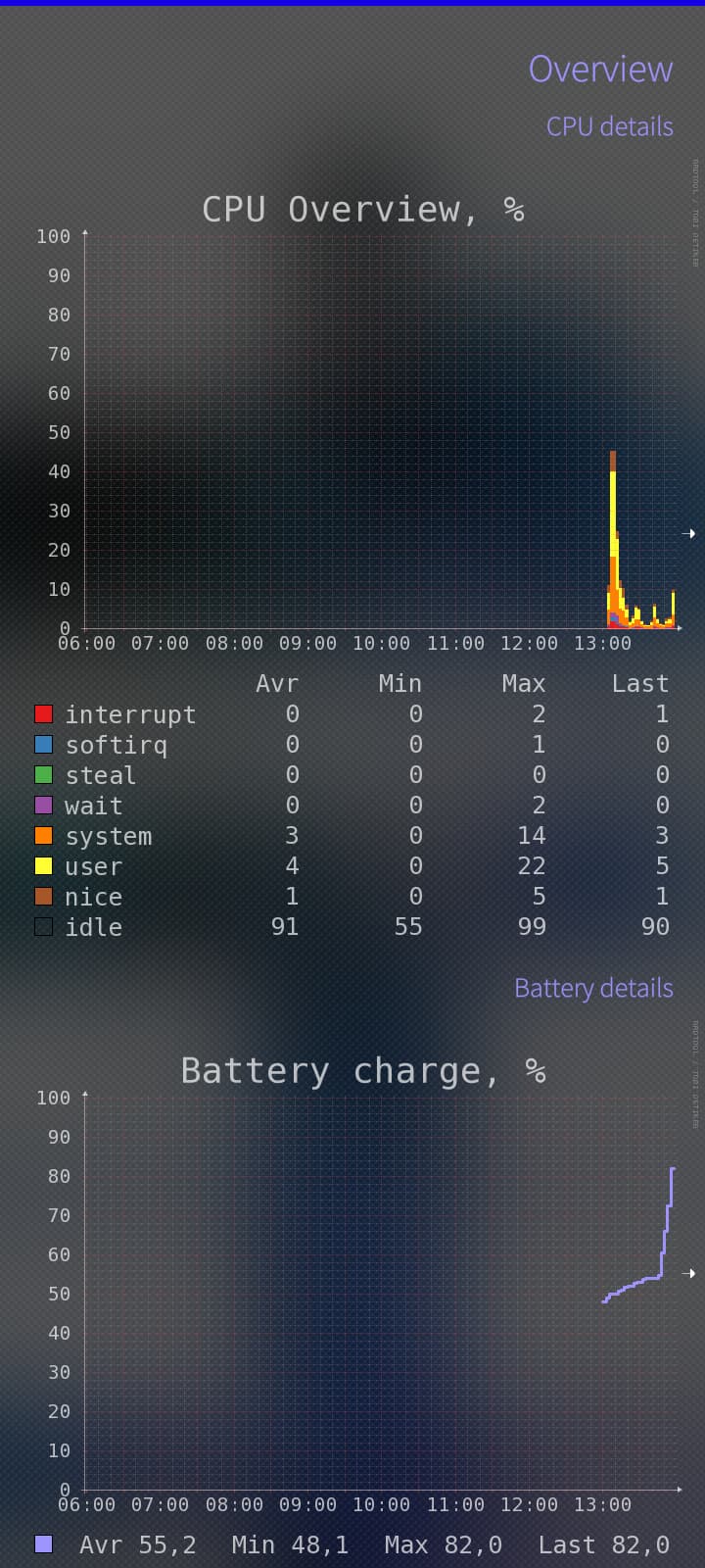

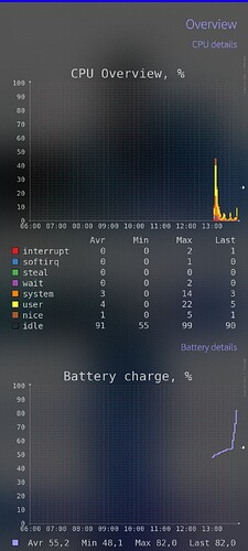

Just got a phonecall and as you can see from the screenshot, after that the battery charge indication suddenly started growing significantly faster.
From that I’m pretty sure that HW is broken.

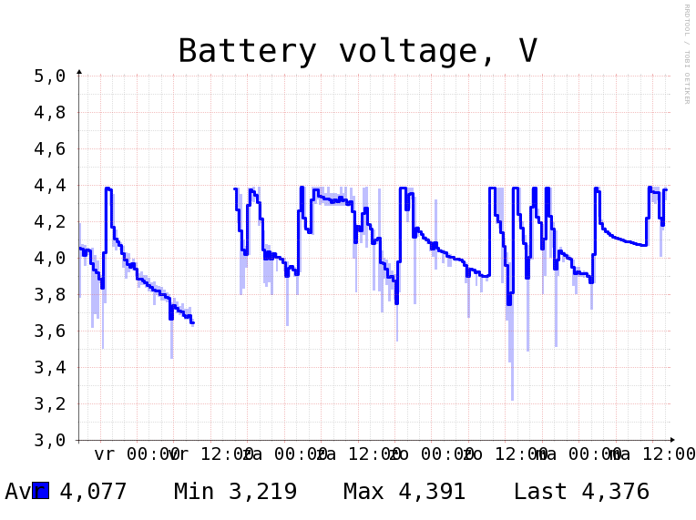

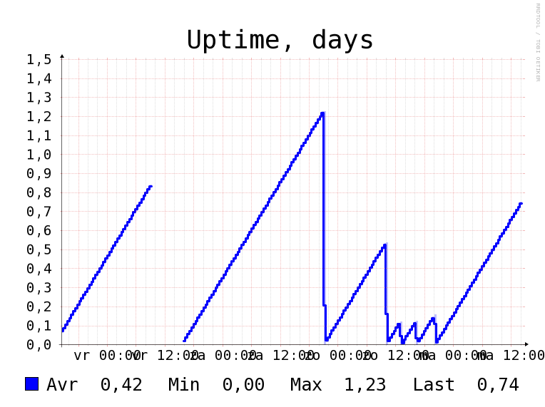

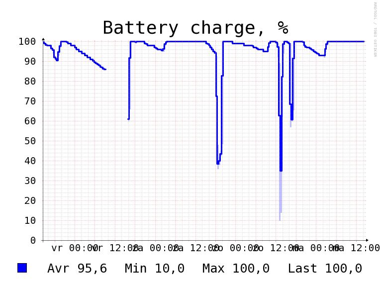

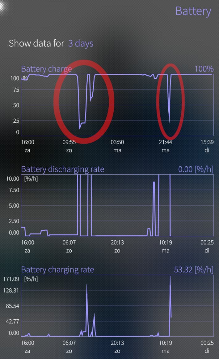

I submitted a tarball with rrd-files to the Zendesk, anyone knows how to load these into pandas dataframes?
The graphs below show several shutdown while the phone was disconnected from a power supply: gradual %-drops until shutdown and often a sudden much lower % at bootup.
Affected, too, also before the latest updates.

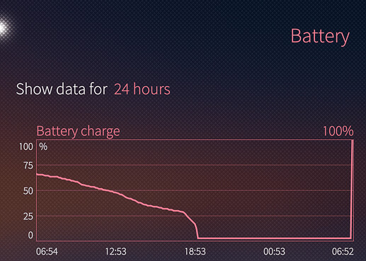

Everything seems fine until around 40% battery. It then drops within 5 minutes to less than 5% and shuts down…
So the shown percentage doesn’t seem right…

Hm, at least System monitor does not lose it previous data when my C2 has these very sudden blackouts like SystemDataScope.

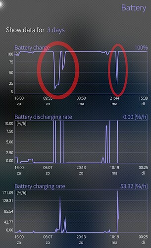

First circle shows two blackouts:
  • Slow charging at around 25%, suggesting some trickle charging limit due to very low battery charge?
  • then fast to 100%,
  • and another crash shortly after disconnecting the external power pack again,
  • trickle charge from “55” percent to ~5% increase and then fast to 100% again.
