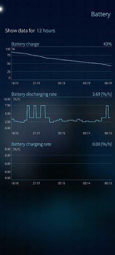

Is it dropping while plugged in? Something unusual is definitely going on then.
No, no not while plugged in. Just doing nothing but then drop down 15-20% is to much. But I did a total reinstall this evening, install some apps, so curious for tomorrow morning.
@mive not that good as yours. And this is only Wifi, and GPS most of the time off, no bluetooth.
Excellent news ! Once again, thank you for all the work :star_struck:
I think that Wifi is draining the battery on the Fairphone 5. If the phone is on 4G or 5G drain is normal, but on Wifi with a lot of Wifi point in the neighbourhood it really drains a lot faster.
