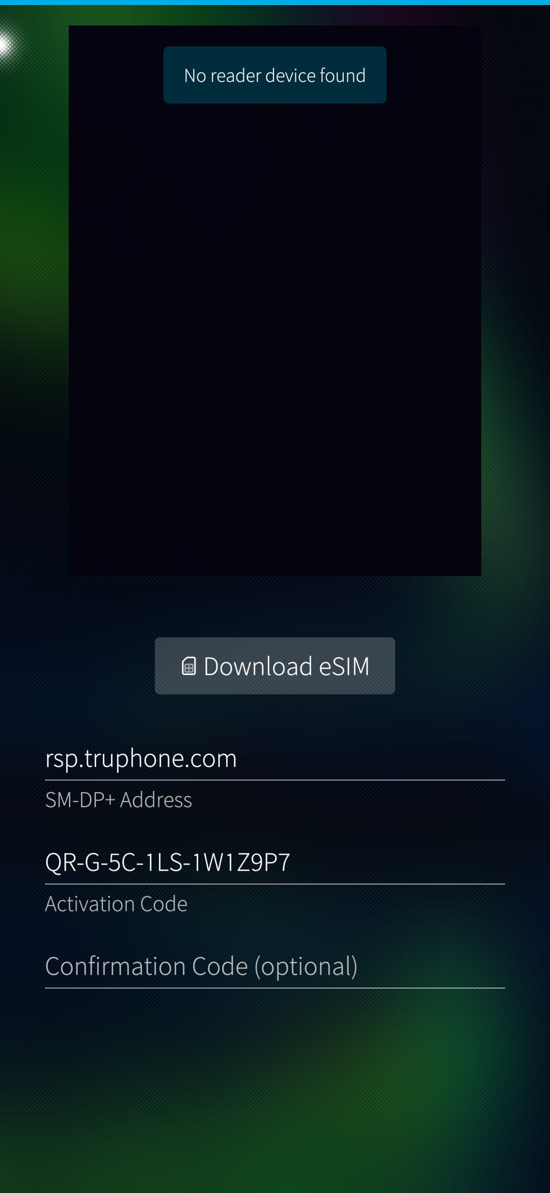

I tried to use firsty with SimPro on my Fairphone 4 but it said “No reader device found”.

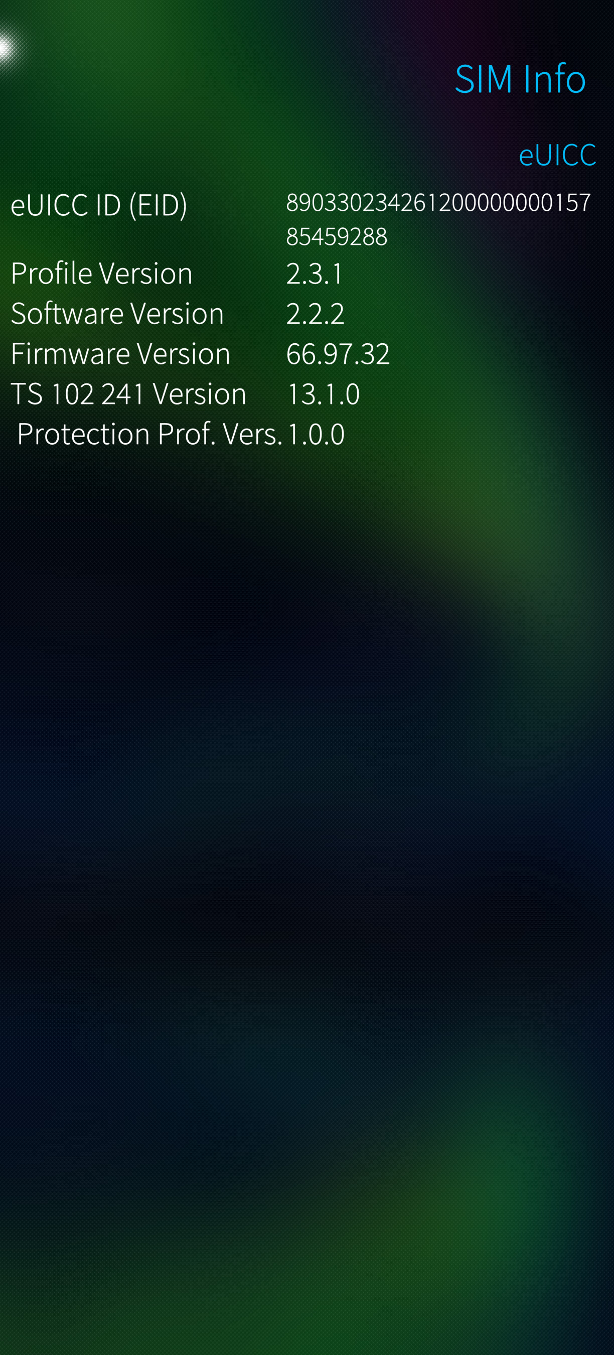

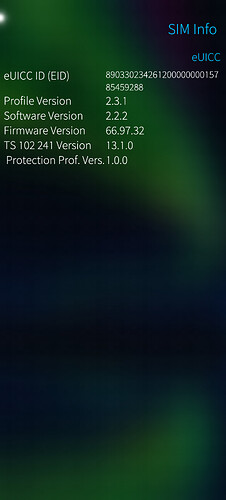

With SimPro I get on my FP5 this output:
I don’t have an eSIM yet and it seems that the internal chip is detected.

At the moment, there is no possibility of putting the Lpac of Sailfish (the backend that SimPro uses) with the Android support, so when you give it to install eSIM in firsty, you have to give it to the manual option to manually enter data with SimPro and set the alias.
Yes when I tried it, I entered SM-DP+ Address and Activation Code manually.

Now I tried again with the code from here: Sailfish OS for Fairphones devices - #339 by cypherpunks
After a few seconds of the loading spinner this is the result:
Click the Download eSIM?
