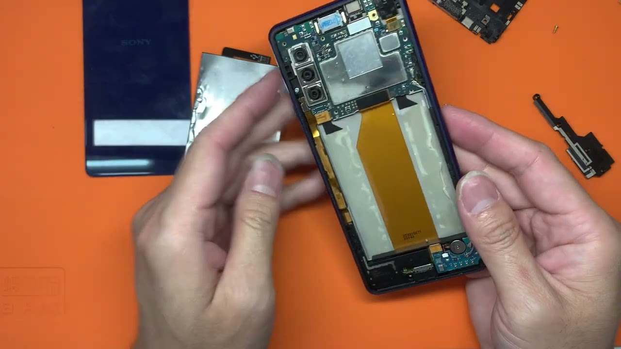

If it’ll be necessary to open the phone and let it dry inside, then here
is a video that shows how to do this.
The usage of a guitar plektrum is a very good idea when removing the display and unplugging PCB connectors, with my tiny screw driver I always feared to make some short circuit.

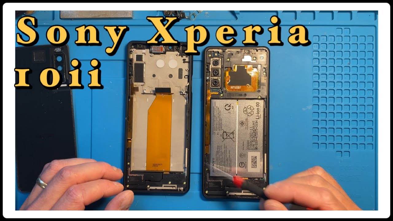

Just for interest: Display change using a professional machine:
What I don’t understand: Is there no flat cable to the touchscreen at the X 10 II ? At the X 10 there is one.

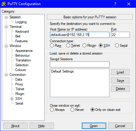

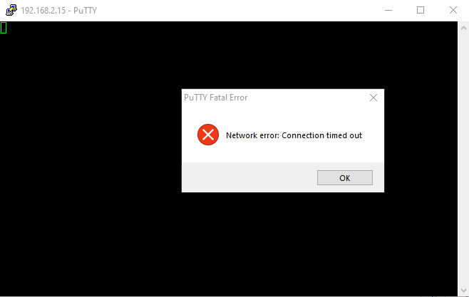

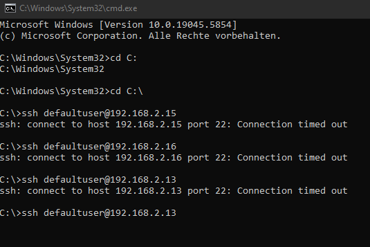

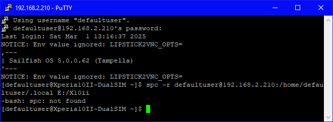

Hello, can someone please help me? Unfortunately, the same thing happened to me yesterday. The display on my Xperia 10ii is damaged and the screen is black. Luckily, I can unlock it with my fingerprint and it has been connected to the charging cable ever since. I was able to save everything visible in /home/defaultuser overnight via USB. But now I also want to copy the invisible folders like /home/defaultuser/.local etc. because they contain some app data (shellEx) that I don’t have anywhere. Can I use SSH to copy these folders to the PC or to an inserted SD card? I’ve tried using cmd and the command ssh defaultuser@192.168.2.13 to establish a connection via USB and also via WLAN using a browser, but it times out. I would be grateful for any ideas.
I found this, SSH and SCP (Windows) | Sailfish OS Documentation but also with my secound phone and active ssh I cant get contact at the phone with PuTTy and defaultuser@192.168.2.15?
I switch off also firewall and awast…
What is the reason?

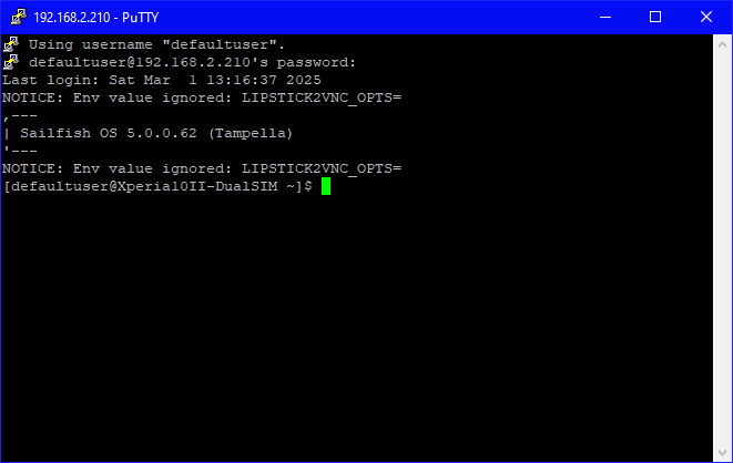

Was ssh access enabled before the screen broke? WLAN on?
Maybe you can connect to it using WLAN, not usb.
Now I have it. With USB no chance but with WLAN its run. Now I need commands to copy the unvislible Folders from home/defaultuser/…
I will look in the forum and if I found I post it also here.
I found this to copy folders over SSH:
scp -r /path/to/local/dir user@remotehost:/path/to/remote/dir
In my case I think:
spc -r defaultuser@192.168.2.210:/home/defaultuser/.local E:/X10ii
But I will read more before I test it here https://askubuntu.com/questions/446724/copy-folders-not-one-file-using-ssh-ubuntu.
its not work :frowning:
Try scp instead of spc.
And use the Windows command in Windows. Sailfish knows where /home is but has no idea of E:\
I would just mount something (network share, SD card…) somewhere and use Midnight Commander in Sailfish. Or use Filezilla in Windows.
Now I have a solution:
Because the SSH is in the Phone its easier to copy .local to Backplocal under default user. This new folder I can copy via USB becaus it is visible in Windows.
I used: `cp -r /home/defaultuser/.local /home/defaultuser/Backuplocal
After some minutes the folder wascopyed.
Maybe anybody can sharethe right line to copy directly from phone to the PC but I think for this we need the IP from the pc and the Username?
I will save also .cache and .config and maybe some other, but ssh had surly no root right to /usr or /etc ord /var but I will test it. I had luck because I saved the patchmanagerfolder from /usr to /home.
If you want to copy from phone to Windows PC using scp you need first of an ssh server running on Windows.
Usually that is not the case.
