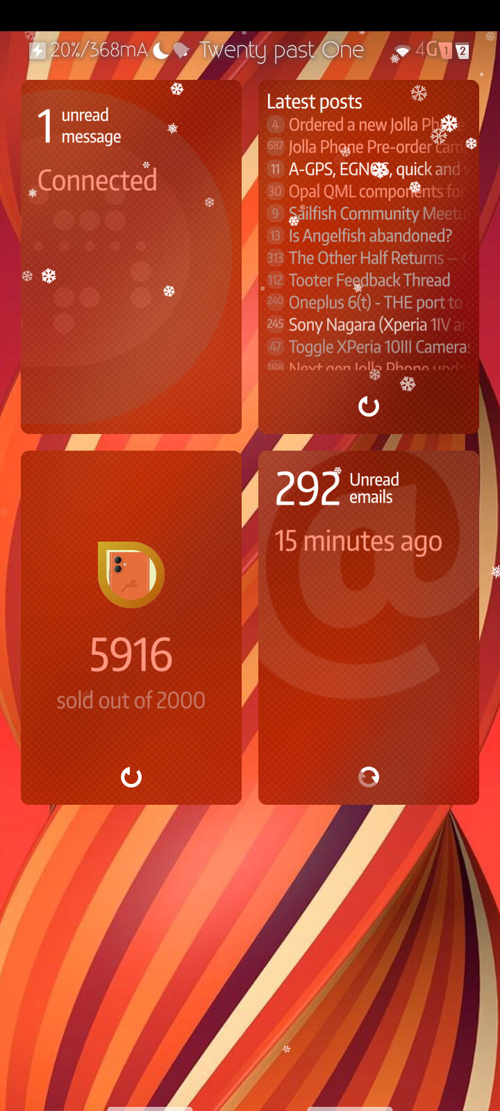

New fun patch published on Web Catalog. Enjoy!
Very cute, many thanks @nephros !
Beware though it does eat battery…
Oh, thanks, but consumption doesn’t grow when the screen is off, or?
Consumption since install (with XA2 sleeping) seems very correct.
You’re right about that! Didn’t expect that much.
