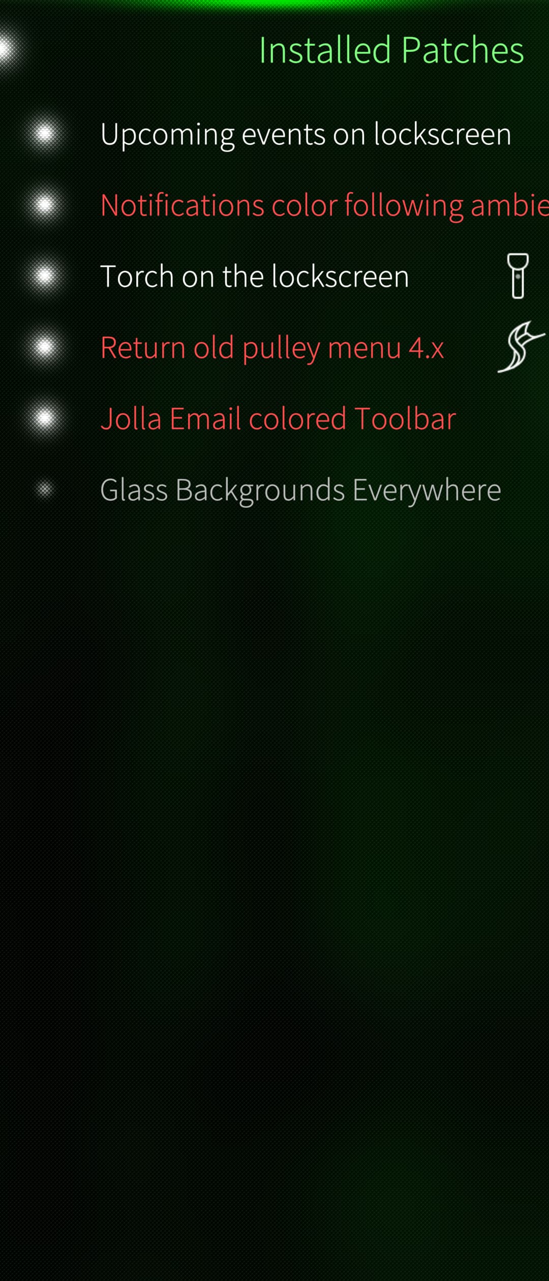

Patches by nephros
You’re saying it doesn’t apply on 4.5?
Nonono, they’re not Buttons! No. They are… square things. Slates. That you can tap. So TappySquares or InteractiveSlates.
Not Buttons, can’t be, that would be Like, and We are Unlike.
well, if you phrase it that way…
Actually also a tappable List of entries could be interpreted as lengthy buttons.
Your arrangement however looks pretty nice. I consider to install the patch although I don’t use cars.
Or InteractionSlate? Yes, of course. Not buttons. Bad UI mojo. Bad. (I gotta get rid of some buttons!)

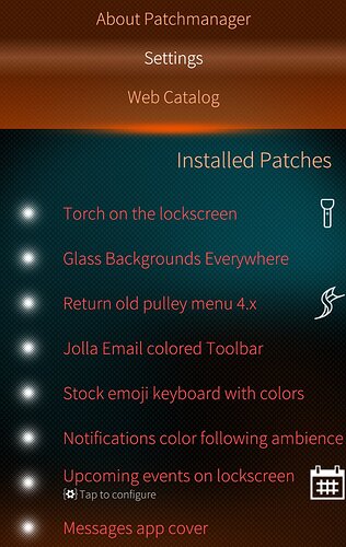

Hi thanks for all your work i only have problem to activate Glass backgrounds everywhere on 4.6.0.15
pm_apply 2025-01-28T07:59:06+01:00

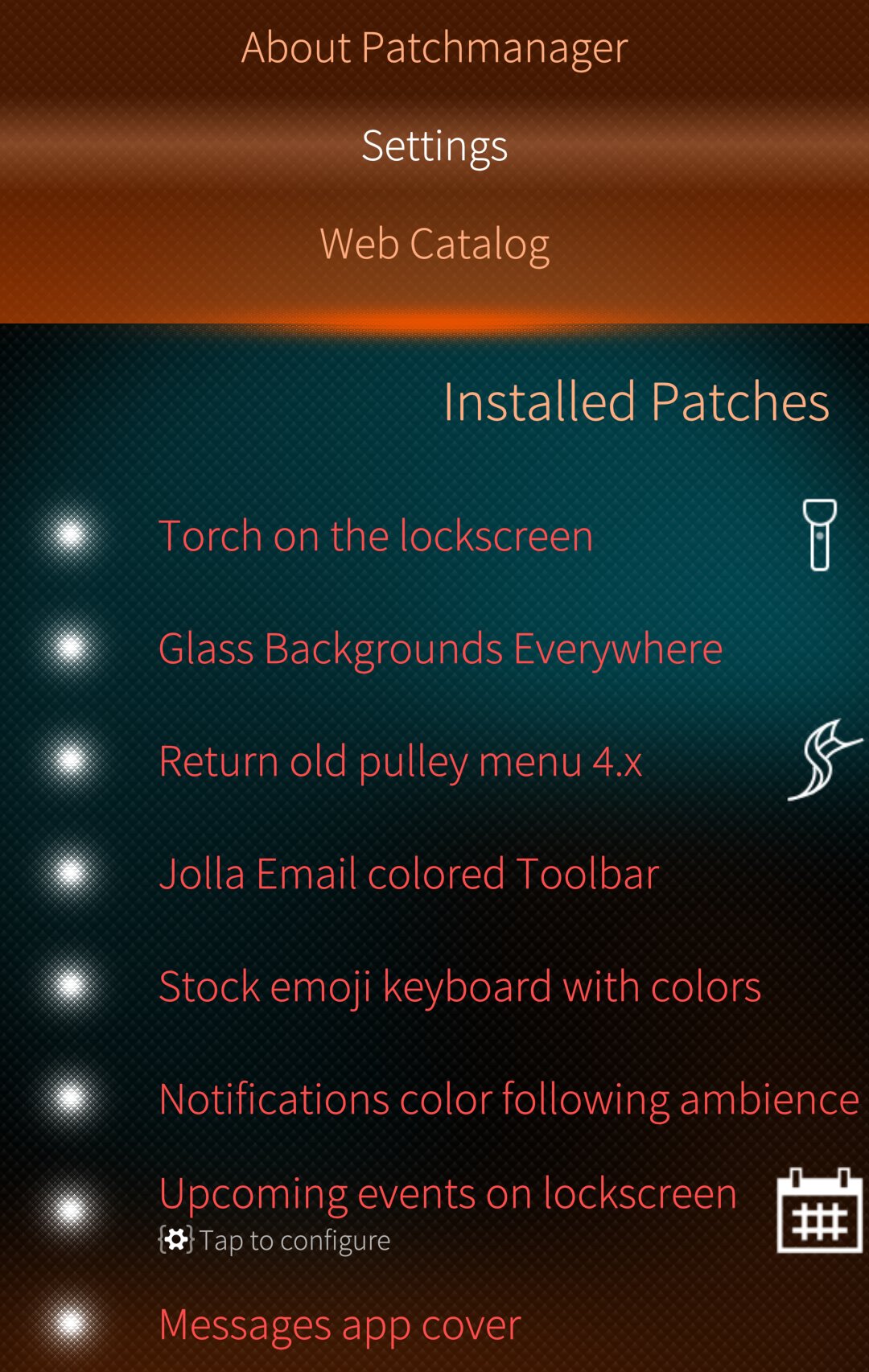

edit: i found that problem will be aarch64 in my case: for example first file is located here: /usr/lib64/qt5/qml/com/jolla/gallery/ambience/Wallpaper.qml
Thanks for the detailed report.
Patchmanager should take care of the lib64 thing automatically.
But the current version has a bug which makes this fail sometimes.
edit: my bad, somehow i had disabled convert 32 <-> 64 bit patches in PatchManager settings :slight_smile:
