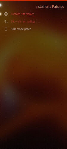

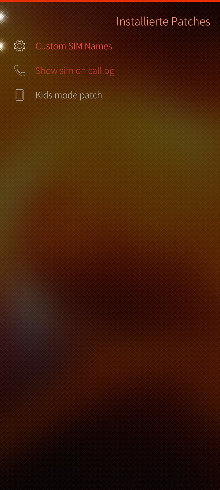

This is from my C2 from Settings > Patchmanager:
…and I think I had the “Launcher combined patch [Fork]” installed before too, but I uninstalled it to test the Kids mode patch which said it might have trouble otherwise.
