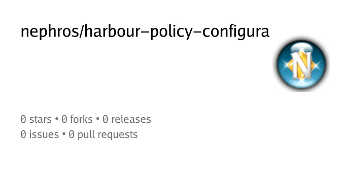

Just for kicks I played around with the Sailfish Policy (MDM) framework.
I have made a PoC application that can switch on/off the exisiting supported Policy settings.
I’ll have to clean it up a bit but then the code will appear in this repo:
Notes:
  1. This app is SETUID root. THIS IS BAD, BAD, BAD! Caveat usor.
    (The reason for this is write access to the policy location (/var/lib/policy, which is writable by root and the special group sailfish-mdm. That group has special properties and I don’t want to deal with that currently, therefore the binary runs setuid root. Maybe setgid sailfish-mdm would suffice.)
  2. In the current implementation, only Browser and Camera can be switched on/off. The rest is an exercise for anyone expanding on this code. See src/main.cpp and src/wrapper.h for the very simple magic, and refer to this for the missing calls.
  3. This is an experimental PoC or example or experiment. There’s no indication that this is a good way to go about it (in fact the MDM documentation if I read it right sais it is not).
  4. I will not provide a runnable binary or installable package for this. You are on your own, and need to do your own tests.
    That being said, you can compile on-device using
    rpmbuild -bb --build-in-place rpm/*.spec |tee build.log 2>&1,
    as long as you have installed the necessary dependency packages.
