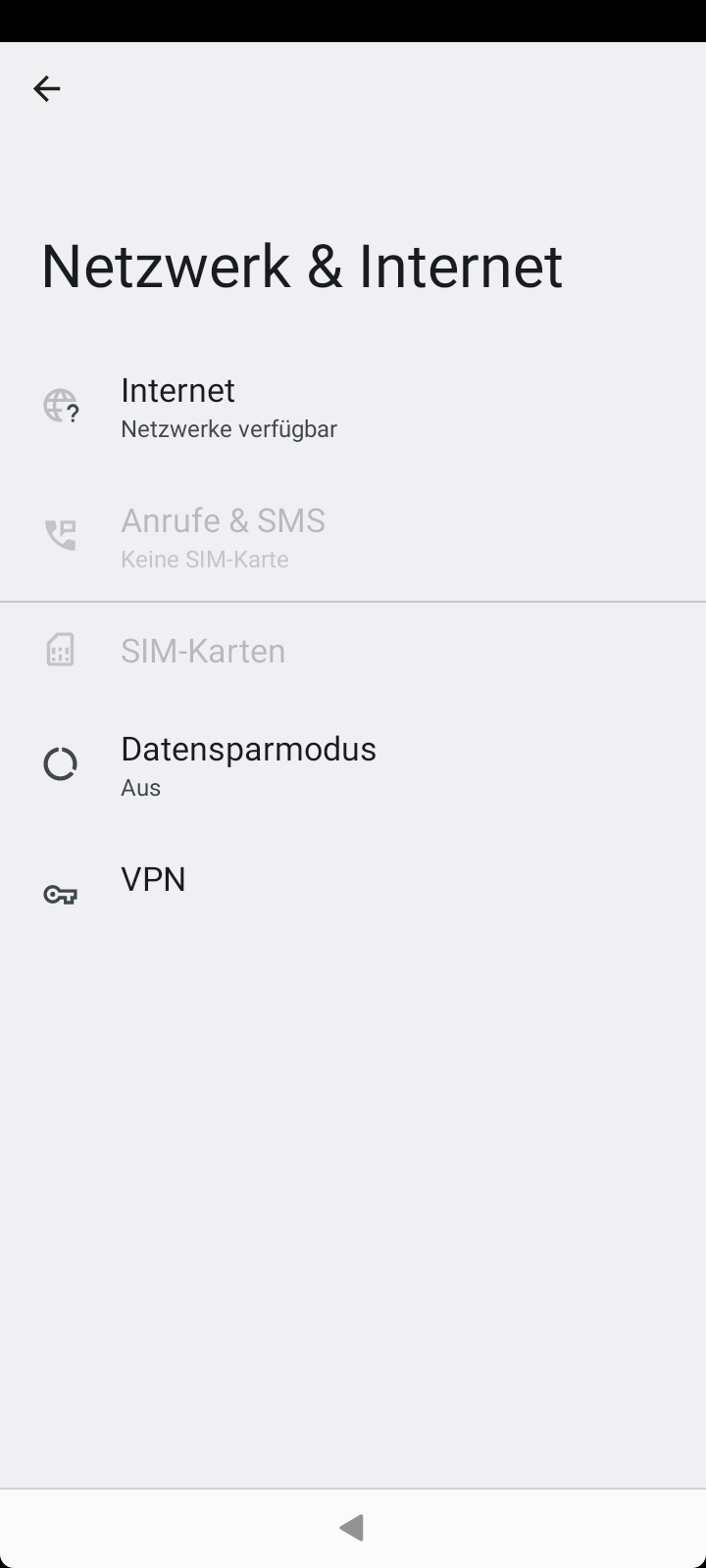

My sim-card settings are completly disabled. How can I activate it in the android settings?
You can’t do it there. Workarounds are mentioned in the Release notes:

The internet connection settings of AAS (after tipping 5x on the AAS version in the settings) report that it is connected via mobile data to my carrier (congstar Germany in my case), even when the device is connected to a WIFI. Then, when I switch off mobile data in the top menu or via the SFOS settings, all android apps report that there is no internet connection.
In the connection settings of AAS it has a greyed out “Internet settings” with a question mark. And when I tip on that, it tells me that I “don’t have permissions to change WLAN settings”
