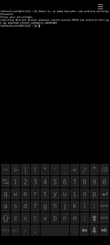

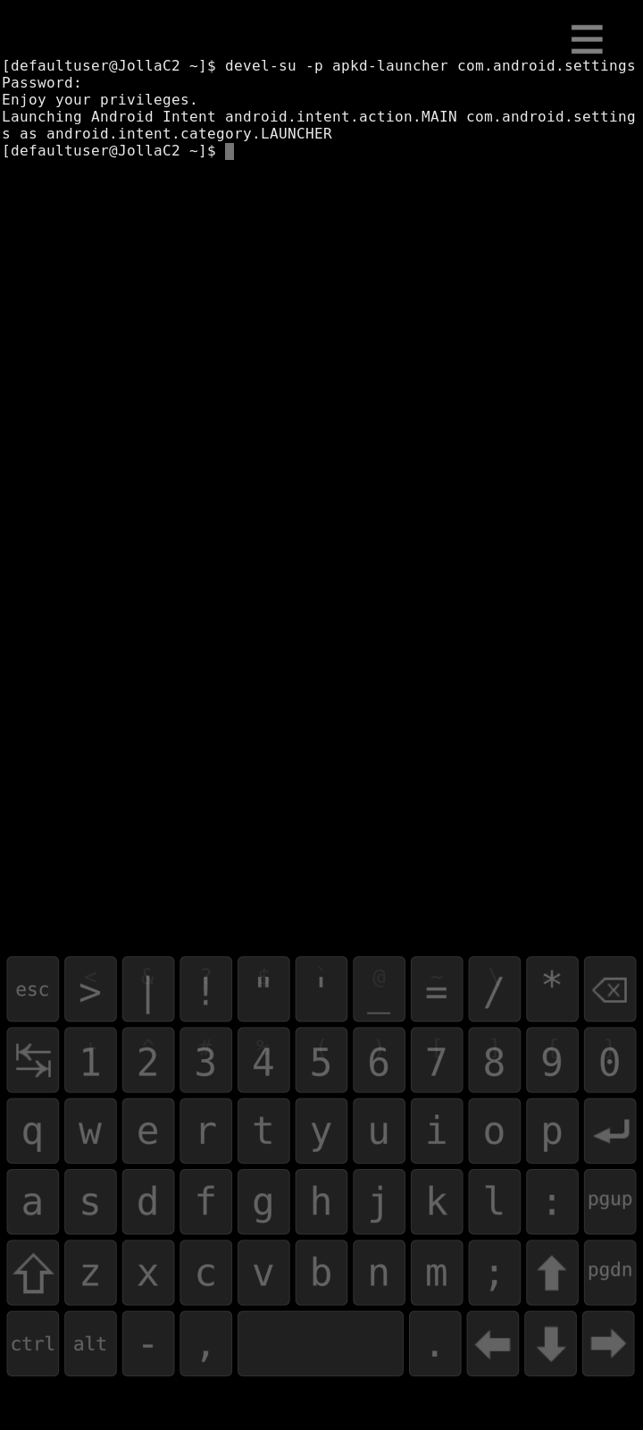

Hello friends,
After installing app suport for android and microG, I’ve started the android setting via terminal app by writing devel-su -p apkd-launcher com.android.settings
after that Android Settings will open and you’ll have to select Network and Internet → SIMs → Access point name and then click on the plus + button in the right top corner for creating a new APN. Write a name for it in the Name field and write in the secound field the APN as defined by your Sim operator. Get back to APNs page and check the box of your new APN. Now, I think a restart of the phone is enough and all of my android apps are working without the need of wifi.
i hope this will help others with jolla C2
Welcome rastau. You do have 5.0.0.62 installed, right? As that works for a few versions on C2. At least for most of us.
Very nice finding nonetheless!
Right, I have 5.0.0.62.
