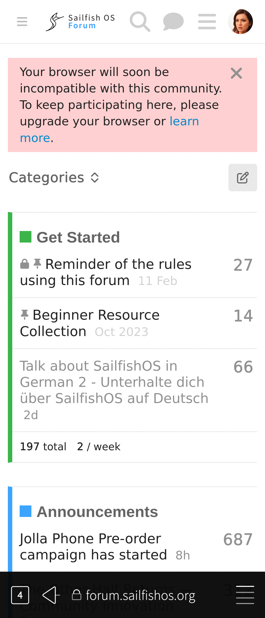

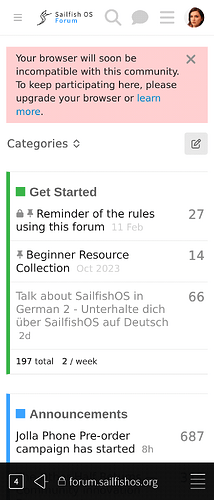

hello, i hipe this is right forum section for this question. on many websites there are messages, that the browser is not compatible. are there any plans for update the browser, and what is planed with new Jolla phone?
An Update of the Browser to ESR 102 (i think) is in the works. Browser version is not tied to the device, so for Jolla Phone 2 it will be the same
ok. thanks for info. but why ESR102? this version is already too old. or do I not understand something?
I guess because the ‘sailfishification’ process takes a very long time and the ESR release schedule moves far quicker than Jolla can realisically cope with. ESR 102 went out of support in September 2023 I believe, the oldest ESR version still in support now being ESR 115 until March 2026.
Jolla is therefore always playing catch-up. Probably a different approach for the browser is needed, one where Jolla has to do little or no work to get it to run, or to maintain it at modern versions, on Sailfish.
