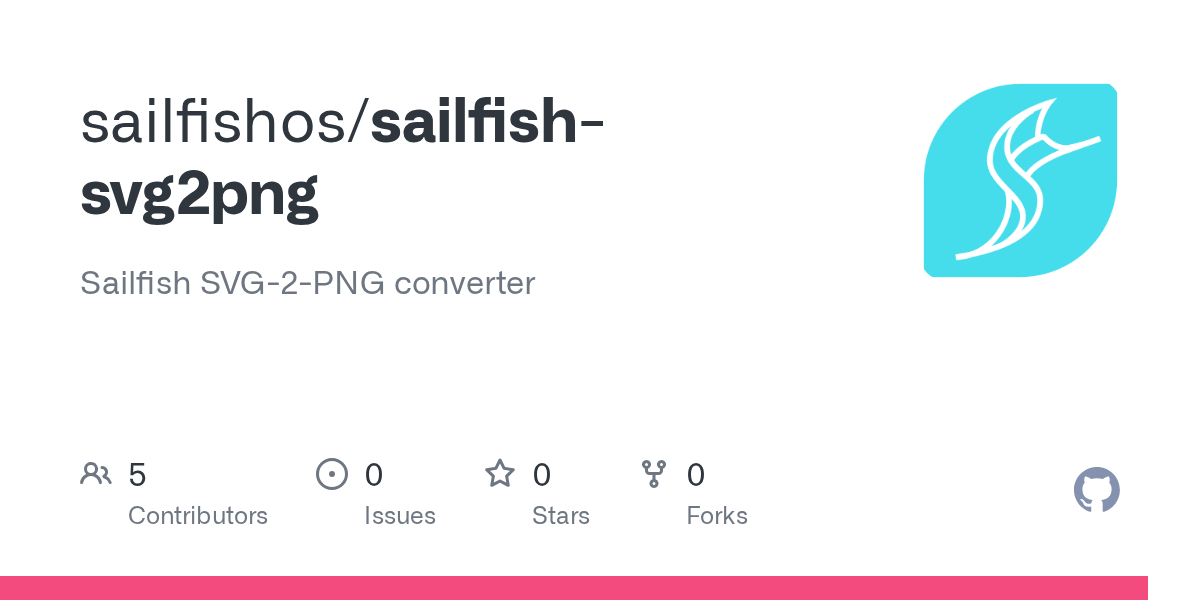

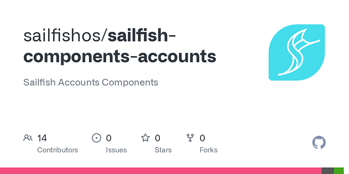

After the NextCloud, we have been preparing open sourcing of following two components; Sailfish svg2png converter and Accounts components. Former is an utility tool that is used to convert (rasterize) scalable vector graphics (svg) to raster graphics in this case portable network graphics (png). Why converting at the first place? Simply because raster images are faster to load. The tool renders different scale factors creating a folder for each scale factor. This way we have optimal size icons for the target resolutions. When to contribute? For example, when a community port would require properly scaled icon package. NB, all platform icons are converted to pngs with this tool. Later component carries a QML module for accessing accounts and performing single-sign-on with accounts which the user adds via the system settings application. Please enjoy!
