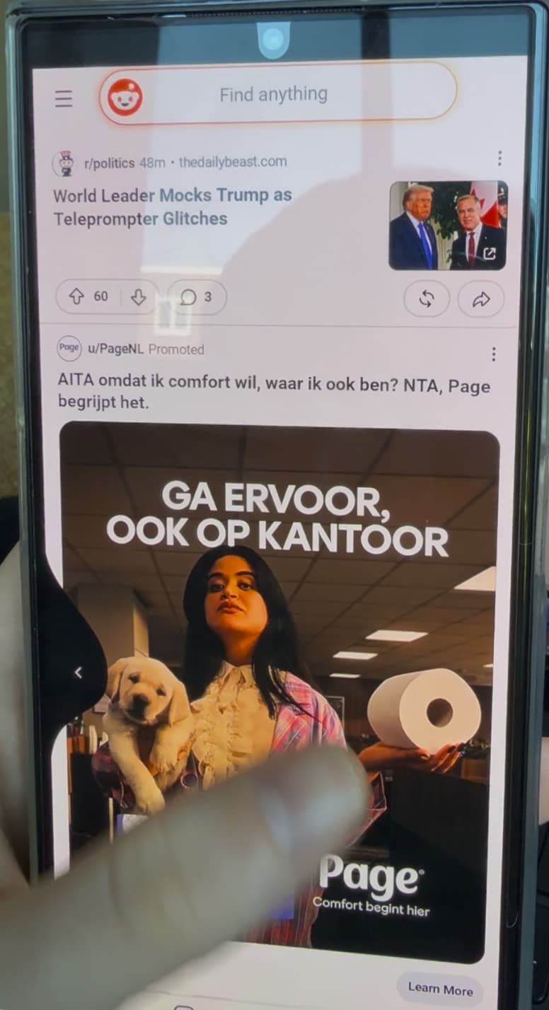

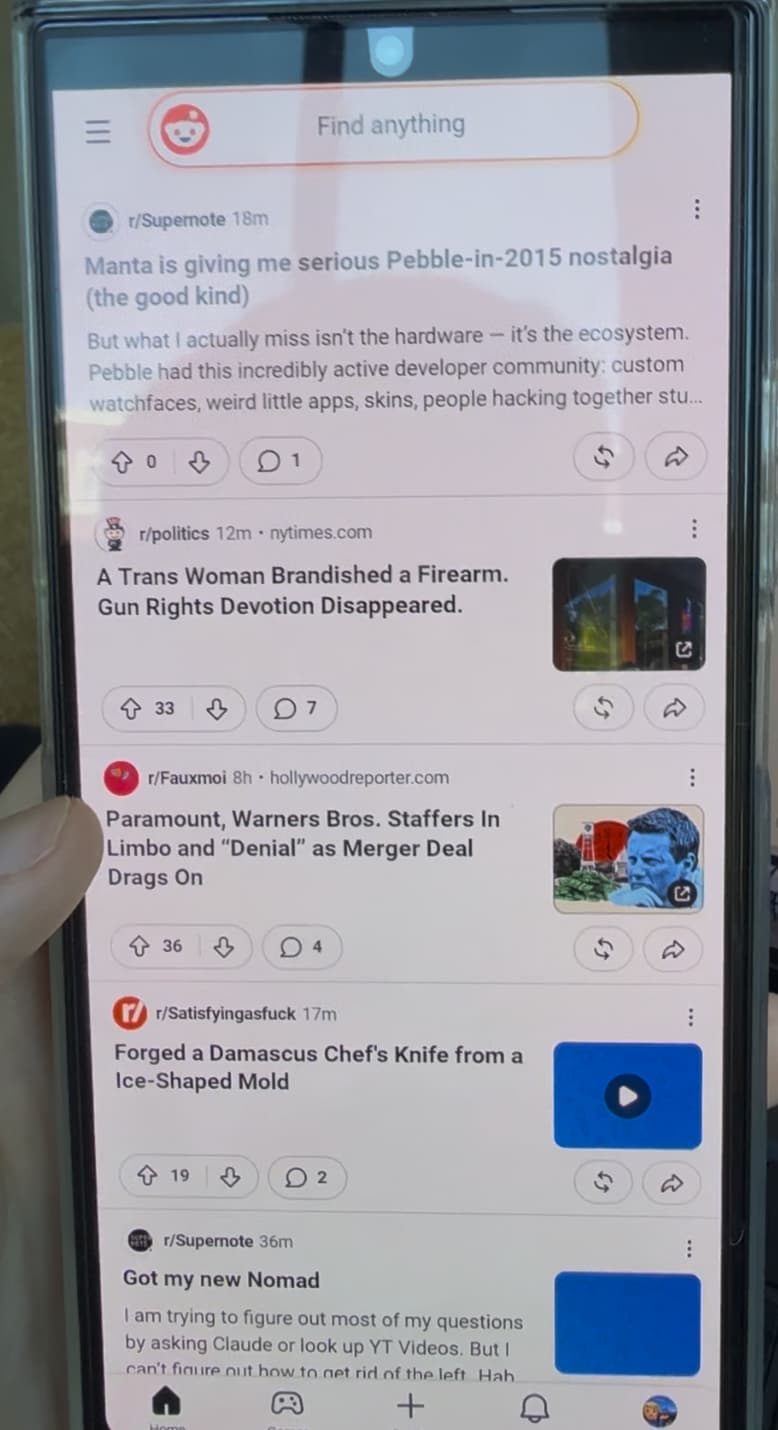

Then I got tired. So I just grabbed an apk that adds gestures. Fluid Navigation Gestures
And voila.
Swiping right retains it’s existing functionality of minimizing apps. Swiping left goes back in Android apps (with a little animation).
It also doesn’t mess with the UX for Jolla Apps too much. You can no longer minimise applications using a left swipe, but going back to a different screen still works as expected. You can also do this now from any part of the screen, instead of from the middle. I actually really really prefer this. Swiping from the right to minimise feels fairly natural, and doesn’t conflict with my muscle memory of other platforms.
