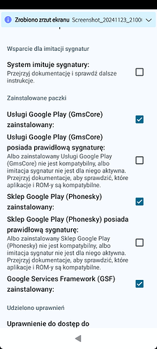

New versions didn’t change much. The self check gives somewhat shorter list of options with some that can’t be activated.
very weird, but i really did the same and it worked for me.
what else i would try: remove all the microg apps, install them again. keep an eye on installing the highest versions.

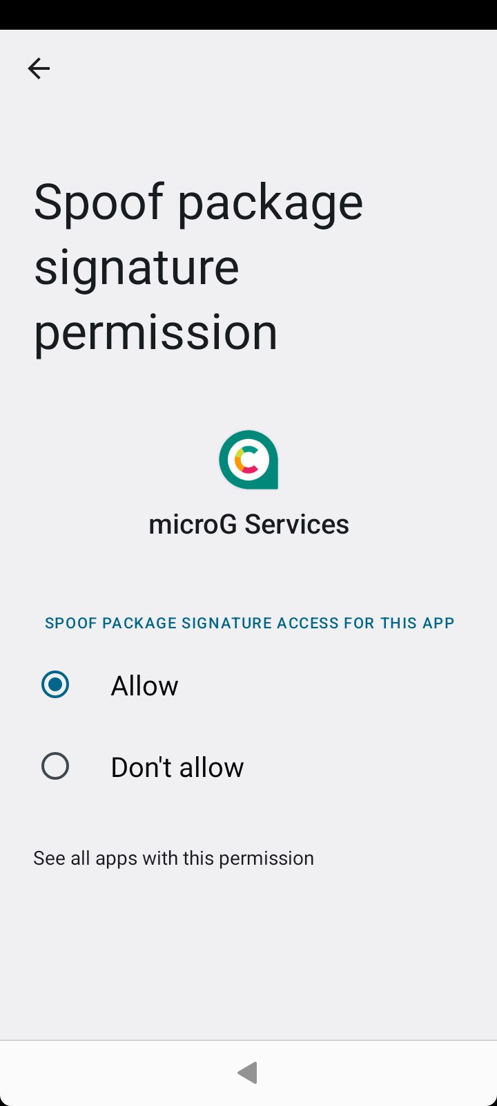

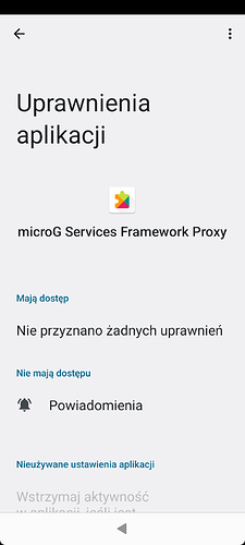

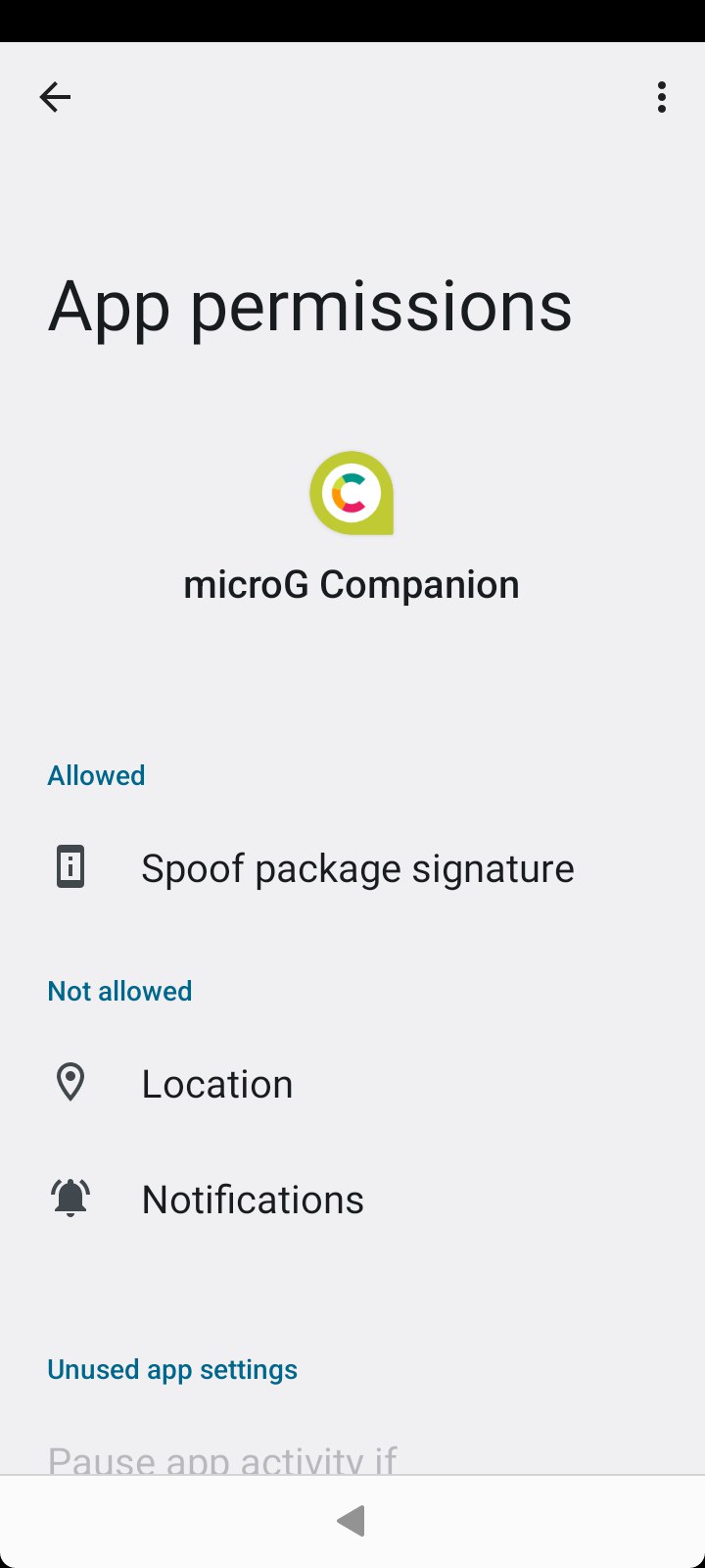

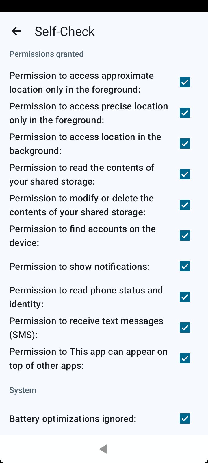

give them all the needed permissions by tapping multiple times on every point in the selfcheck.

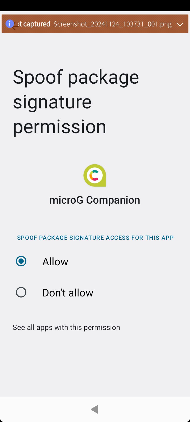

i try to post my permissions screenshots tomorrow

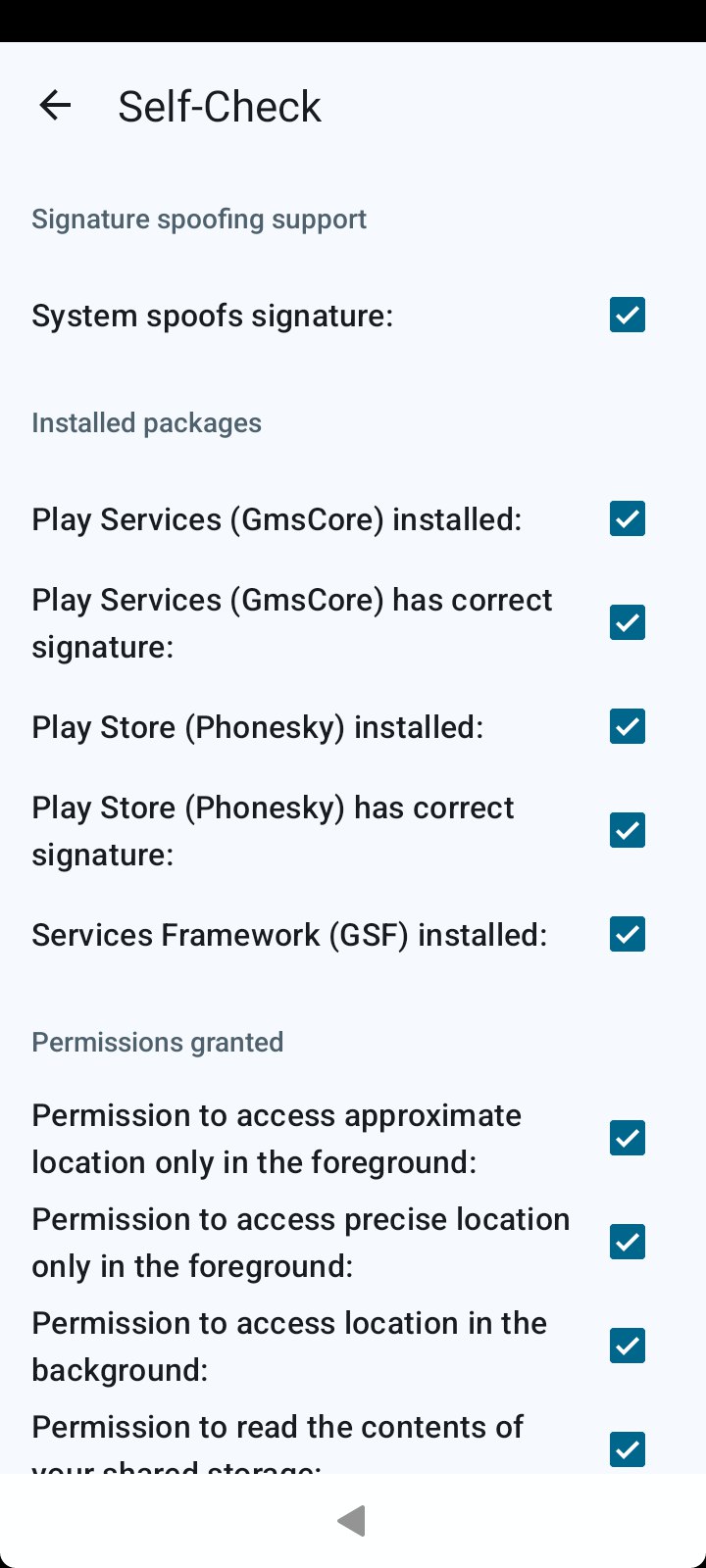

After reinstalling appsupport I installed F-droid, added the MicroG repo and installed the MicroG apps. Now I was able to tick all boxes in the Self-check, and Signature Spoofing Checker turned green.

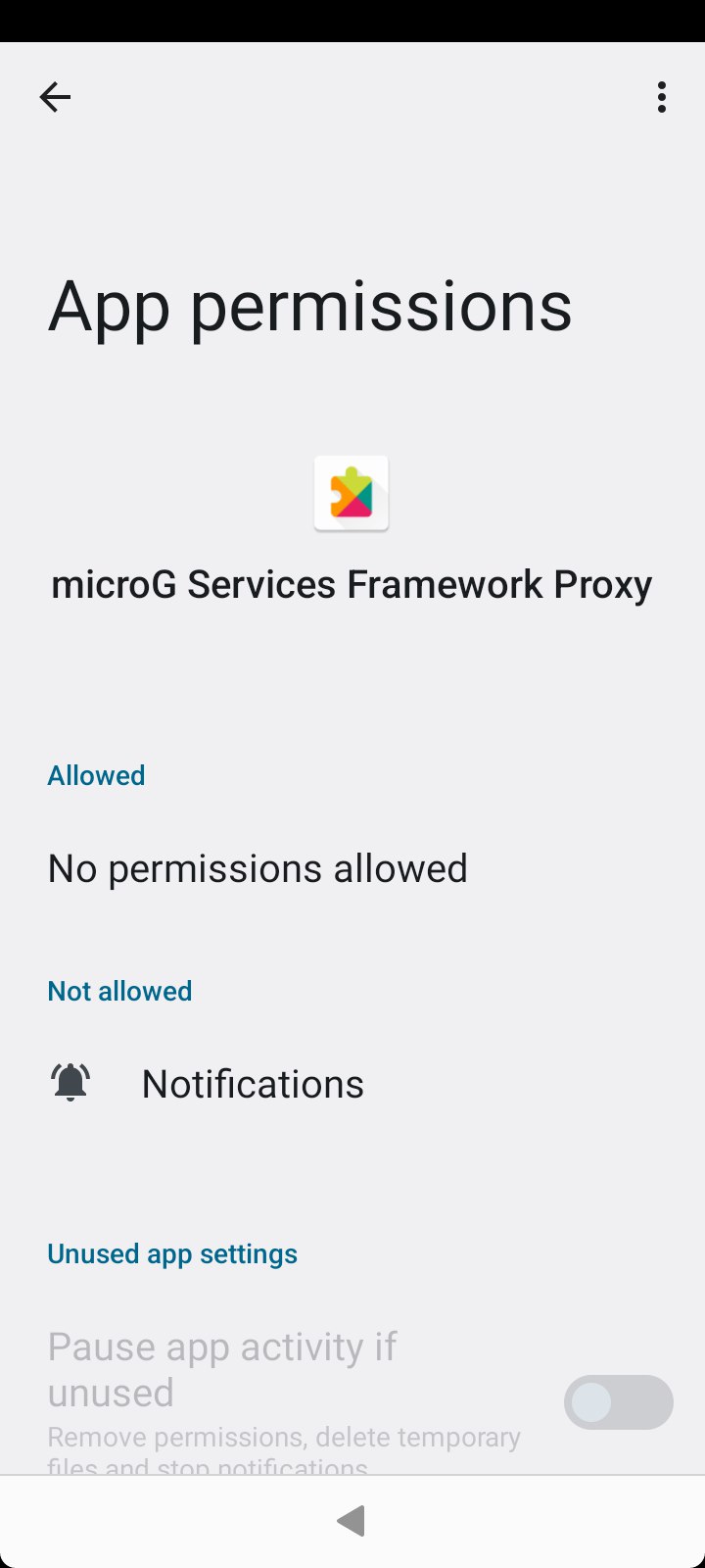

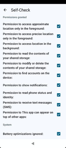

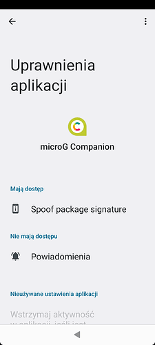

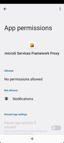

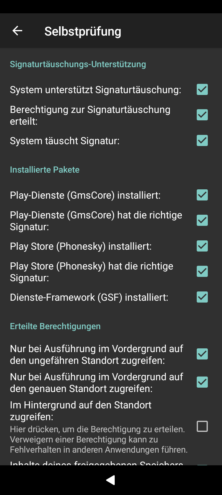

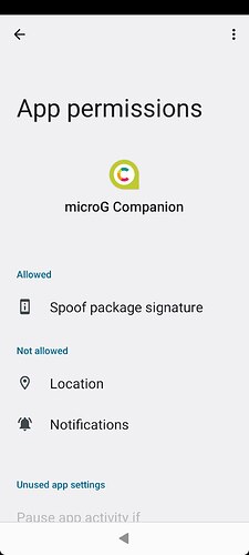

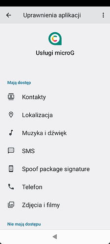

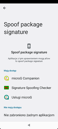

On my C2 it looks like:
Can you look if your Permissions looks the same?

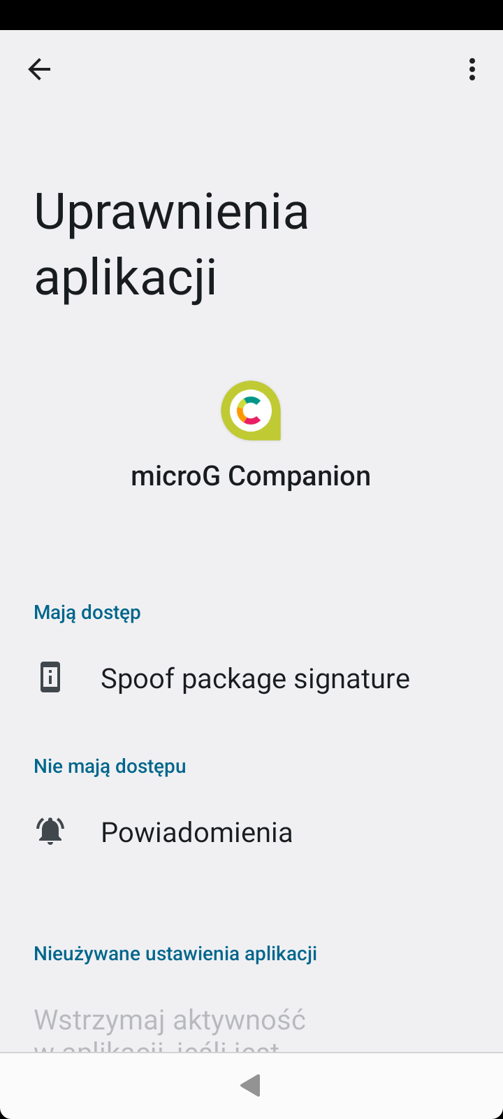

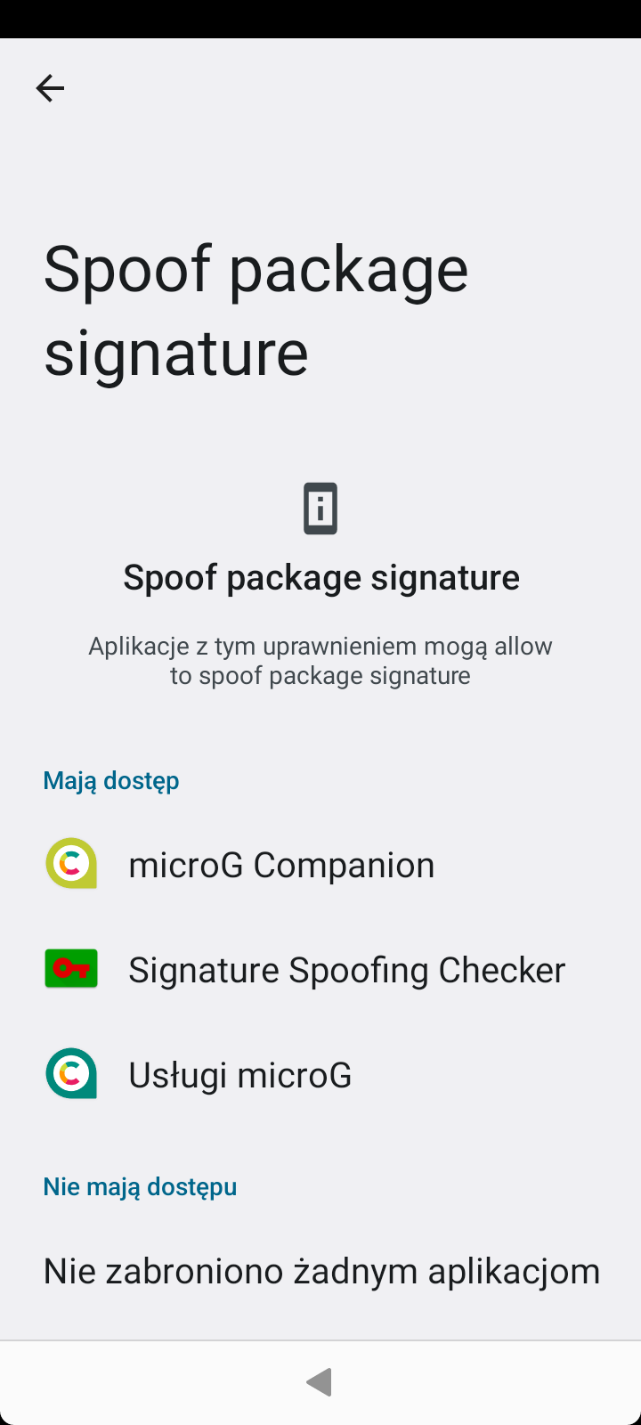

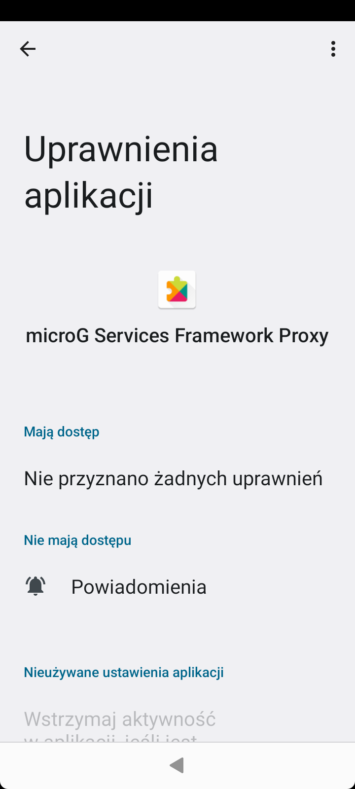

In my case it looks like this.

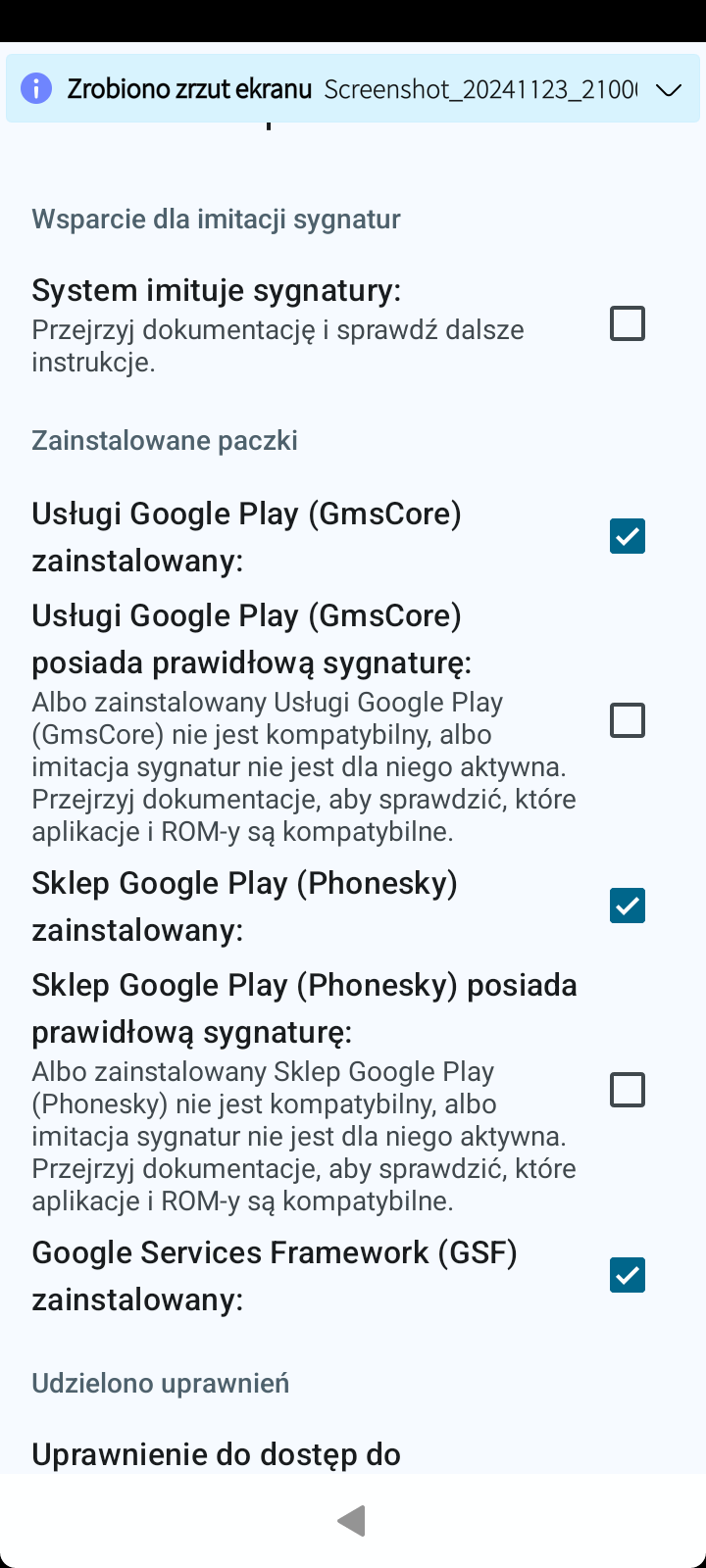

i can remove app support in a clean and brute way once again and install from the scratch but why doing the same thing all over again should give a different result?
and how to remove microg files that dont have an icon?
I confirm that it is necessary to remove app support in a clean and brute way as was mentioned earlier and install from the beginning. Now i can activate almost all boxes, thanks.

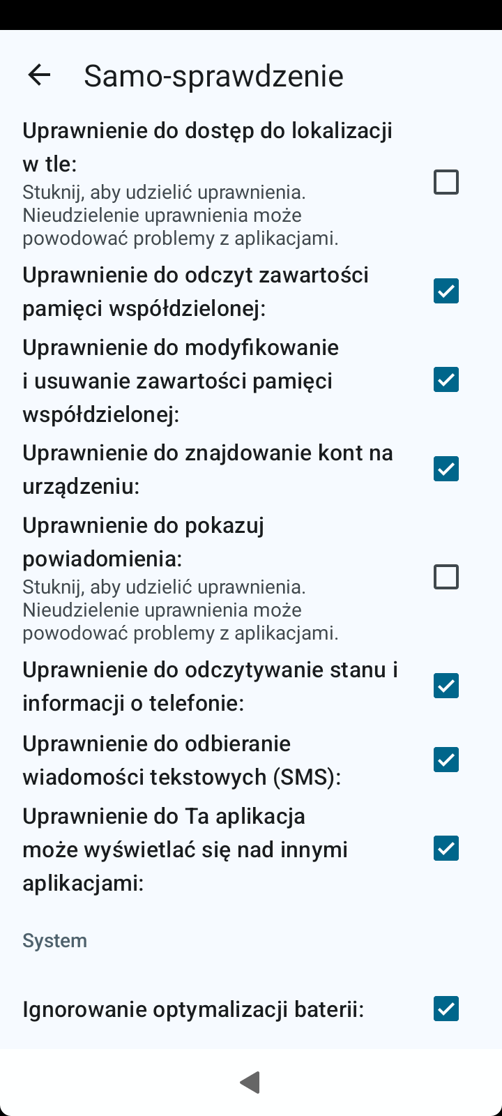

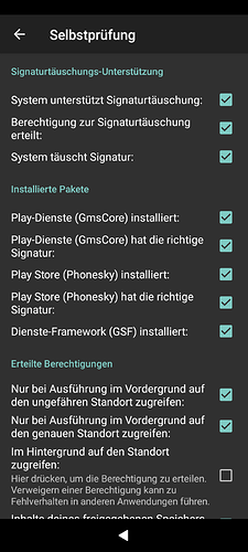

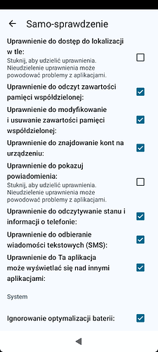

These two cannot be checked. Background localisation and notifiaction.
Notifications work for me but not background localization
Maybe :
  1. Settings within Sailfish: Android App Support: tap on Android Version multiple times and repeatedly until the Android settings menu opens
  2. in the Android settings: tap location, then location access by apps, find Micro-G Services
  3. activate “Always access” for Micro-G.
    It was probably only on “While using the app”
  4. in back to the Micro-G app with your missing checkbox: Now Micro-G has Android permission to always access GPS location, now you maybe / hopefully can activate the missing checkbox in the Micro-G self test settings for permanent background accessing the location.
Thank you this worked!
In my case it also works now. Thanks. What about notifications? It has also something to do with adroid settings?
Enable it in Cloud Messagning part of MicroG Settings
It says that I have to turn on device registering first. Is it necessary? If those notifications are optional I can live without them.
