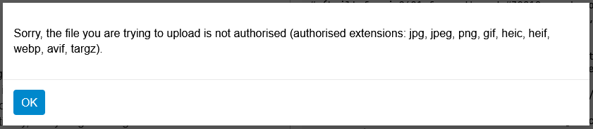

Second time asking:
Please fix your forum to allow proper sharing of files
