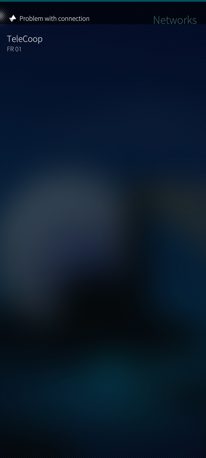

On the networks page, I can select TeleCoop. Then, I have the error message: “Problem with connection”.
Here is a screenshot:
Now, it’s back off again when I disable the automatic searching. I can’t select any network again right now.
