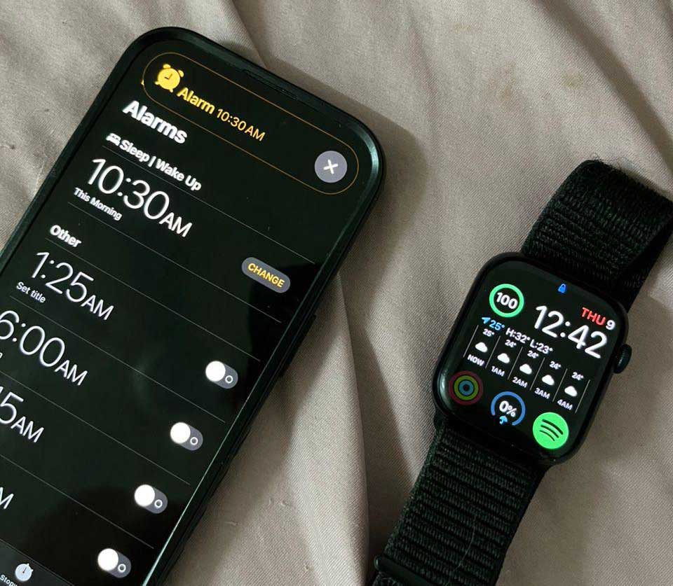

Even the mighty multi billion company Apple has this kind of problem:
:laughing:, you are trying to calm me down. That’s OK, my anger is over, the phone has been working since that incident. I think Apple is no longer able to overlook its huge code base. Too many conditions that no one can see through.
