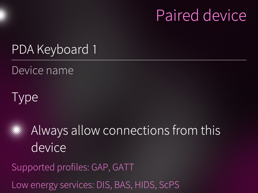

I have acquired a very cool Bluetooth keyboard (or well more accurately, an open source Bluetooth module for the HP G750 PDA keyboard from yesteryear but that’s besides the point).
More importantly this keyboard exposes HID service over BLE, and this does not appear to work at all with Sailfish OS. It pairs without any problems but no keyboard input is registered.
Luckily I can use it wired with a USB cable but that’s not as convenient (and a mouse cursor shows up in portrait when I connect it, any idea if that can be disabled in lipstick or something?).
So does anyone have any suggestions for this BLE HID issue? Should I make a bug report? Thanks in advance.
