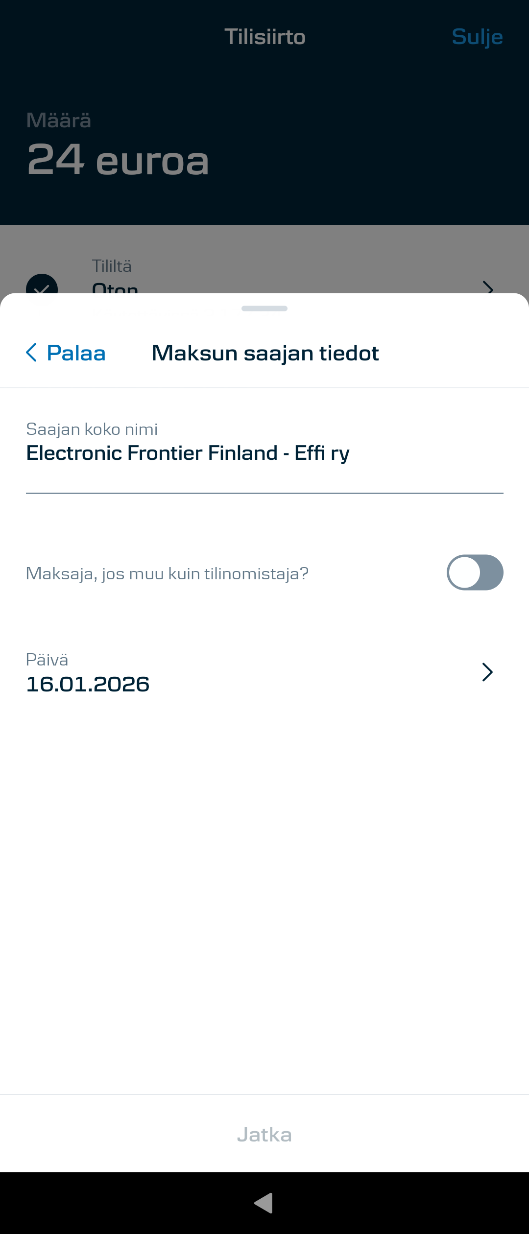

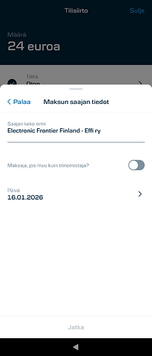

I switched from X10Iii to C2 and I do not manage to get OP mobiili working. I did try echo “kernel.yama.ptrace_scope = 0” > /etc/sysctl.d/91-opmobiili.conf, but still OP mobiili closes before login page. Any hints what to do? I’m running latest version of Sailfish, tried app versions 72, 74 and 75, and MicroG is installed.
I’ve been able to install the Nationwide app and get as far as the login screen without it complaining of a rooted device
Check the file /etc/sysctl.d/91-opmobiili.conf in case the funky quotation marks have made it to the file and the phone can’t parse the contents properly. Also don’t forget to boot your phone after.
Thanks! Everything working now, I think I had not rebooted the device.
