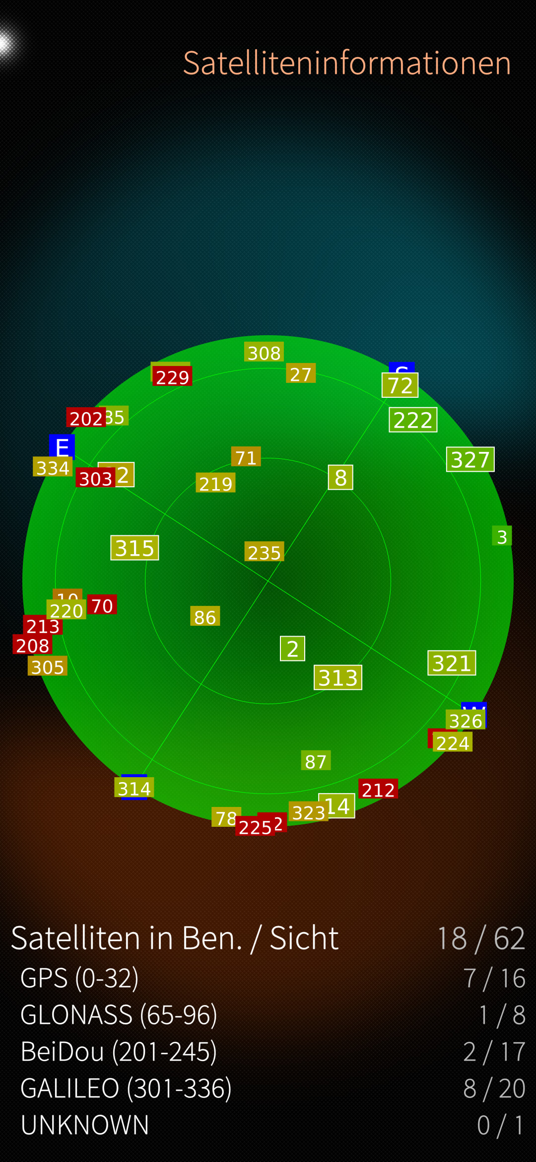

I need a maximum of two minutes with my 10 III. Are you sure your hardware is OK?
I go out, then switch on GPS, start GPSinfo plus OSMScout or Here or Bltzer.de and I’m there in two minutes.
GPS setting is exclusive device mode, GPS only.
10 III, 5.0.0.72, no patches, no tricks
It might take few minutes more the first time leaving a plane in another country.
Same here, just works on 10 iii.
Jolla C2, 5.0.0.72, in the bus, in Finland, from scratch (GPS on, GPS Info started). It takes 4 minutes 4 seconds when Gps position is functioning .
And I worked as expected. Tonight I landed in Barcelona and after the -sadly enough well known- roaming reboot after landing (SIM “lost”) everything worked just fine. 4G, no VOLTE though, GPS after a 2 or three minutes wait and Navigation with HereWego went just fine.
I just wanted to share my experience and my understanding of it. I am a long time SFOS user. GPS always was a problemat first you could help yourself with the mozilla offline packages or A-GPS which helped in some ways, but MLS Mozilla location services were dropped at some time don’t know the reason for. So we stay with A-GPS. For me a soltion to faster get a GPS position is the use of the SFOS App GPSinfo which i start first after turning on location, then i start different map Apps Here, Pure Maps, OSM Maps. This stuff combined gives me a position in a few minutes :slight_smile:
