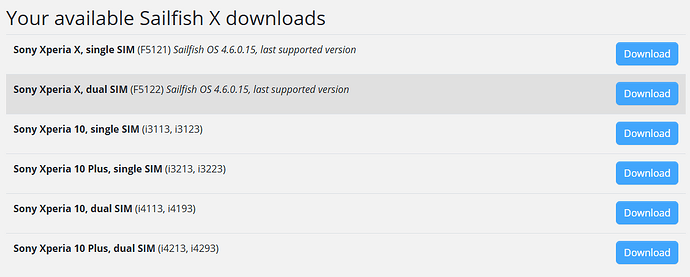

I bought lately an Xperia XA2, before learning the battery drain issue with the latest SFOS version. It seems that Jolla only offers the latest versions to download. Would it be possible for you to share your initial XA2 flash image, in order to be able to setup mine under the version 4.4 and avoid this issue ?
I’ve a single sim one, H3113.
Sorry, I don’t have these images. And I’m not even sure if these older versions didn’t had these problems anyway.
HI, I do see to have in my archive this directory: Jolla-3.2.1.20-i4113-0.0.4.16 - would this help you?
As a sidenote, I have just reinstalled this phone to the latest Sailfish v5, and it’s only connected to Wifi, without any services running. It loses about 1% per hour, which to me seems reasonable.
That would be perfect to get it !
I’ll send you a PM in a minute!
