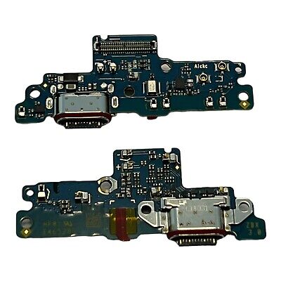

Mine did not charge some month ago either. I changed the PCB of the usb port. Now it works.

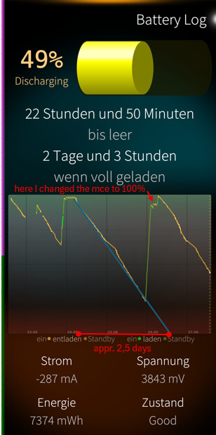

I play with mcetool and found out, why the phone never charge full.
[defaultuser@Xperia10III ~]$
mcetool | grep -i charg
Display on at charging start 3000 ms
Charger cable: disconnected
Charger state: off
Battery state: discharging
Charging mode: apply-thresholds
Charging override: disabled
Charging enable limit: 77 (%)
Charging disable limit: 90 (%)
Apparently, it’s set that way by default, even if you deactivated the charging limit in the settings. It still showed 100%? Only in the Batterylog app I could see that it only fully charged when I charge it in shut down mode via the Sony kernel.
I changed it now with:
mcetool --set-charging-disable-limit=100
mcetool --set-charging-enable-limit=98
The secound thing was a hard reset with Power+Vol up = 3 times vibration. So I came unter 120mA. Unfortunately, a side effect was that some battery files were no longer being filled, and the battery log no longer worked. I hope this will work again someday. The files with no content are
/sys/class/power_supply/battery/charge_full = 0 and /sys/class/power_supply/battery/time_to_ful_now = -1.
Nephros was so good and send me a update from batterylog and I changed also some lines to compare the missing charge_full variable and delet the Text for time to full. Now I can use it aggain.

Does that mean if i enable charging control in BatteryBuddy, for example 85%, i will only get 85% of the 90% set in mcetool?
I think mce makes the major borders and if you go on 100% in battery budy the mcetool setting will end the charging at 90% but in other direction it will work. I changed because this both mce-settings at 100% now. I will see if I charge next days…
