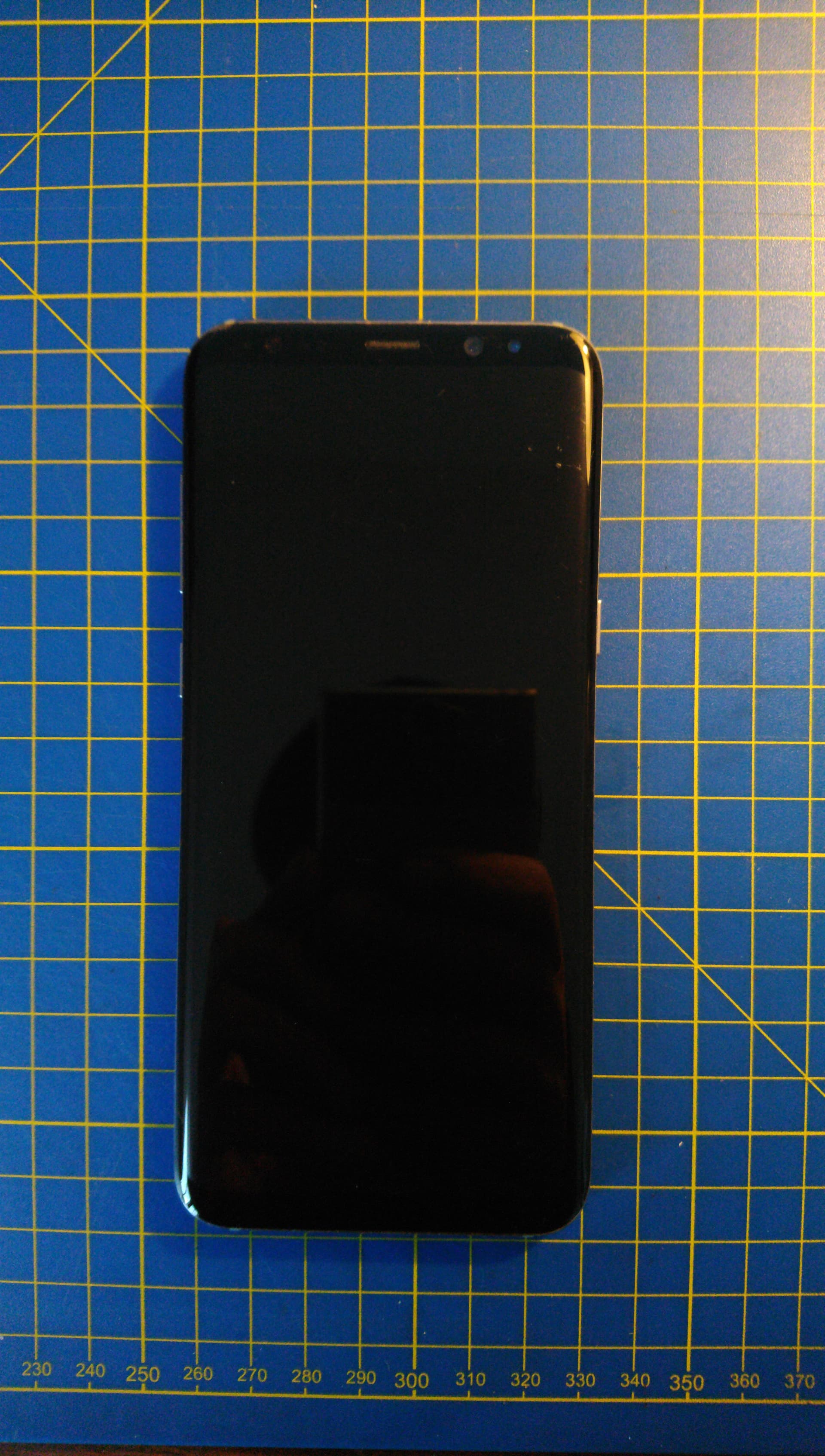

The image was supposed to be a video of the problem I encountered. Here’s a direct link.
