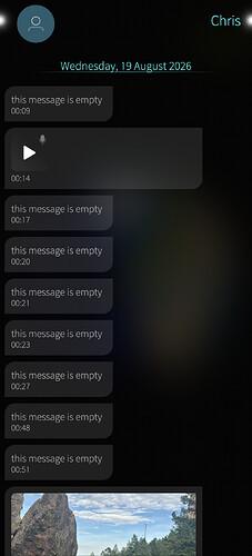

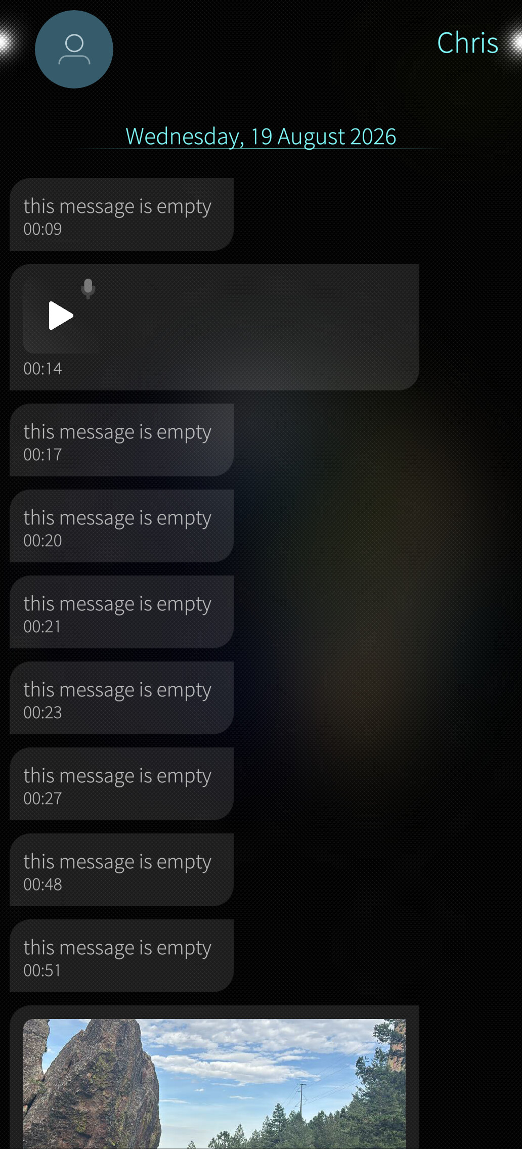

This happens often with audio files, which i use all the time. If I’m listening to a message it shows up, but messages that aren’t actively being listened to disappear if the app is minimised.
Also haven’t figured out a way to bring them back.
Any chance you could run whisperfish with devel-su -p harbour-whisperfish -vv and (privately!) post me the logs of that happening? Preferably of you reveing such audio message, and then minimizing Whisperfish and it apparently getting removed? Thanks.

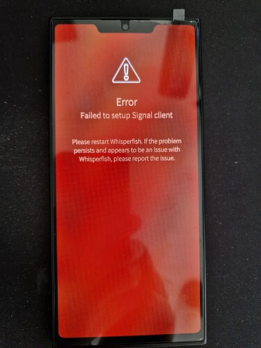

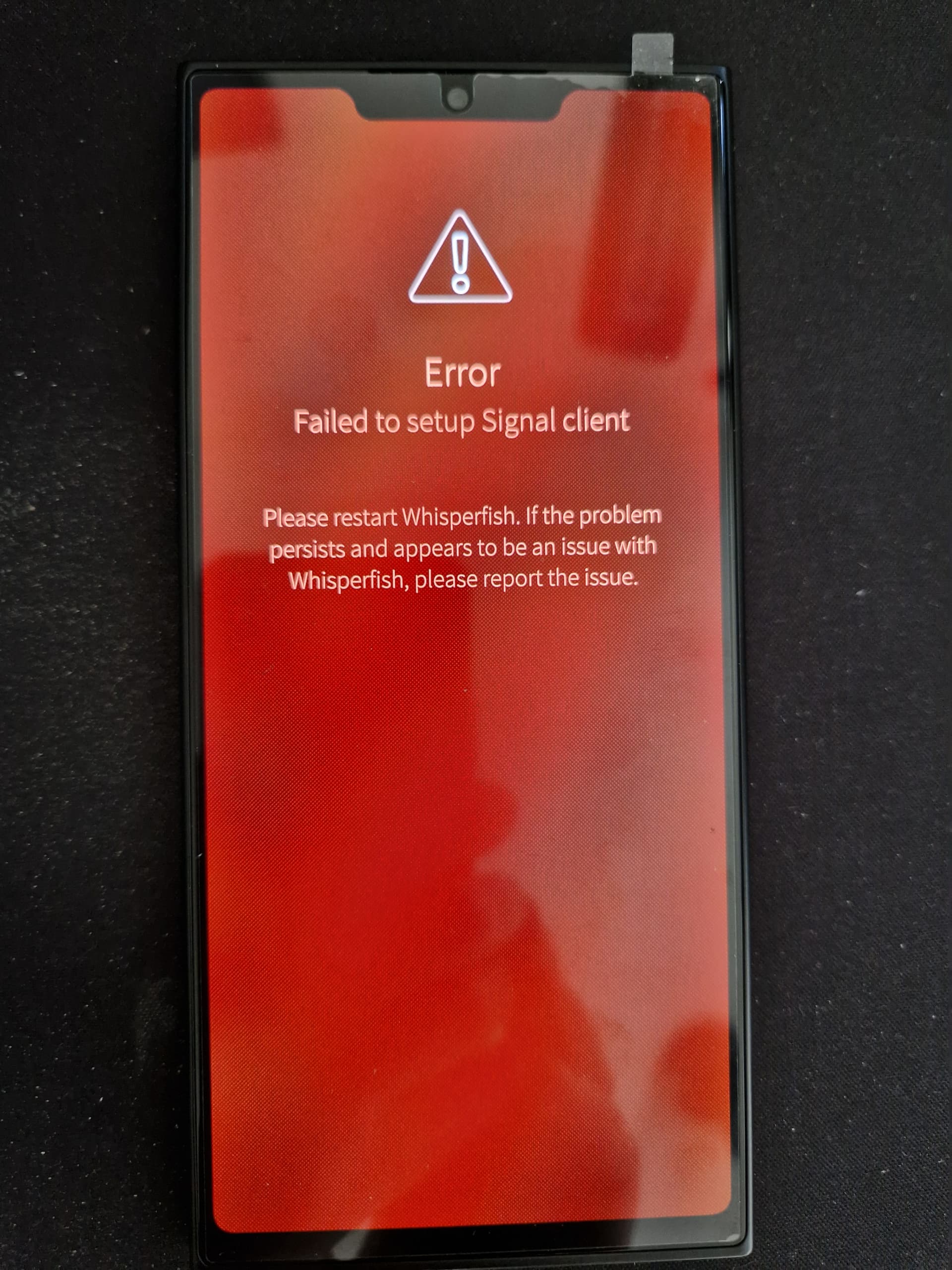

Hello! I got an error message and it seems like Whisperfish is stuck in that error even if I uninstalled it and installed it again. I also tried to restart the phone.
The error occurred when I was trying to add Whisperfish as a secondary device. I had scanned with my old phone (Android if that matters) and the Jolla phone was just loading and seemed to be stuck. I tried to close Whisperfish and restarted it and then I got this error immediately.
I got my Jolla phone yesterday and Whisperfish was one of the first apps I installed so it is possible that I have done something wrong. I installed Whisperfish from Storeman.
I will run the command that direc85 suggested and can send it if that would help.
Reset (Frequently Asked Questions · Wiki · Whisperfish / Whisperfish - Signal on Sailfish OS · GitLab) and install a more recent version from Package registry · Whisperfish / Whisperfish - Signal on Sailfish OS · GitLab. Detalis on https://whisperfish.rubdos.be. If that doesn’t help, logs (as per @direc85) would help indeed.
I urgently need to release a new version that contains that fix + some visuals to the FAQ and that website. I’m starting to spend more time typing out the above than actually coding on Whisperfish now :face_with_peeking_eye:
(Congrats to Jolla for getting so many devices shipped though!)
Thanks for the extremely fast reply! Reset worked and then I downloaded the harbour-whisperfish-0.6.0.beta.42+HEAD.20260812145129.7e75a085-1.aarch64.rpm and then I was able to add it as a secondary device.
Wiping data and installing the beta version worked for me too, thanks! :grinning_face:
Noob question: Will I need to uninstall and install via appstore as soon as the new release is out, in order to receive auto updates further on?
No need to uninstall, as long as you have rubdos’s repository enabled in Storeman, it’ll notify you of any updates and let you install them over the packages you installed directly from GitLab.
