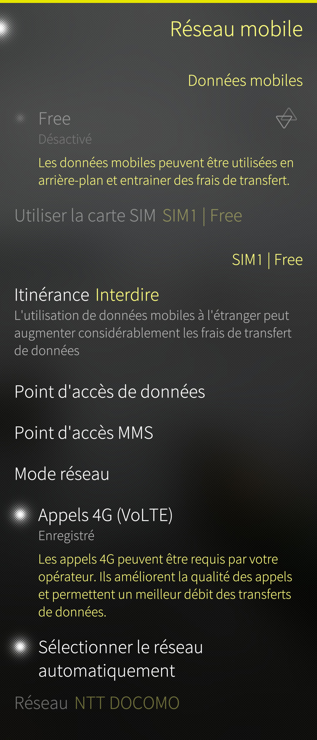

Hi, I try to understand your investigations to active VoLTE on a XPERIA 10 II on Free Mobile, but I certainely missed a crucial step…
Can you synthesis all your process ? Thanks a lot !
I’ve basically followed what @abranson described in this thread for the 10 ii model.
As far as I remember the steps, they were:
  1. devel-su to gain root privileges,
  2. cd /vendor/oem/modem-config/ to change directory,
  3. mkdir S8683.1 to create the missing directory for Free service,
  4. cd S8683.1 to change directory,
  5. echo "mcfg_sw/generic/common/default/vl/global/mcfg_sw.mbn" > modem.conf to indicate to the IMS to use the generic configuration, which seems to somehow work with Free mobile (I’ve the 2 € plan and I’ve checked in my account that 4G calling option is activated).
  6. reboot the device and then check the VoLTE calling option in the phone settings.
Thanks a lot @dcaliste ! I’ve applied and it’s working. I’ll try SMS/MMS exchange tonight.
When I started using it, sending SMS was broken and required to unsuscribe VoLTE to send the SMS and subscribe back after. I tried to change parameters by unpacking the mbn file change some random options and repack it, without success. Surprisingly enough, it started to work by itself after a month. I guess Free changed something on their side.
MMS are working also, as far as I remember (I don’t send or receive MMS very often).
About the calling status, my impression is mitigated. When on VoLTE, it’s perfect. But for reasons I still don’t understand, the phone tries sometimes to fallback to 3G, while the 3G signal is poor and the 4G one is strong. And the call quality becomes thus really bad. This happens quite often (sadly) when receiving a call. But not always…
