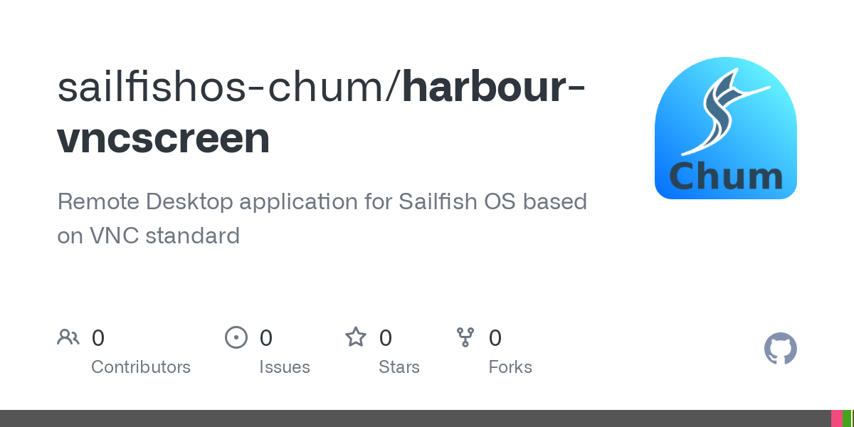

You can’t because it’s not a bug report. I’m going to see if the author will permit it being pushed to chum.
I’m testing from Show home:poetaster:vnc / harbour-vncscreen - SailfishOS Open Build Service and could use feedback if this build works. https://repo.sailfishos.org/obs/home:/poetaster:/vnc/sailfish_latest_aarch64/aarch64/harbour-vncscreen-0.3-1.4.1.jolla.aarch64.rpm
Just installed the linked build and it works fine for me on the 10iii.
Thanks!
Thank you! I’ll push it to chum.

I had not yet pushed it to chum since I was hoping to get feedback from the original author. It’s still in stasis but built at: Show home:poetaster:vnc - SailfishOS Open Build Service
If you clone my version of the repo and make changes I’ll merge them and push them to the repo. EDIT:
But I don’t currently have time to test, so that would be up to you.
First I’ll push my version to chum testing and get that ball rolling.
Ok, I will just try this arm version
State of Repository sailfish_latest_armv7hl for home:poetaster:vnc / harbour-vncscreen - SailfishOS Open Build Service
Will update with a status once I get time to test it out
should show up in chum proper, tomorrow!
I could download the arm binaries and run it on gemini, but not connect to VNC server. Will try again with the chum version when it becomes available.
It is already in chum, I tried with same result - I am guessing I need to manually get all the dependencies listed here: Detailed Information About harbour-vncscreen-0.3-1.4.1.jolla.armv7hl.rpm - SailfishOS Open Build Service
