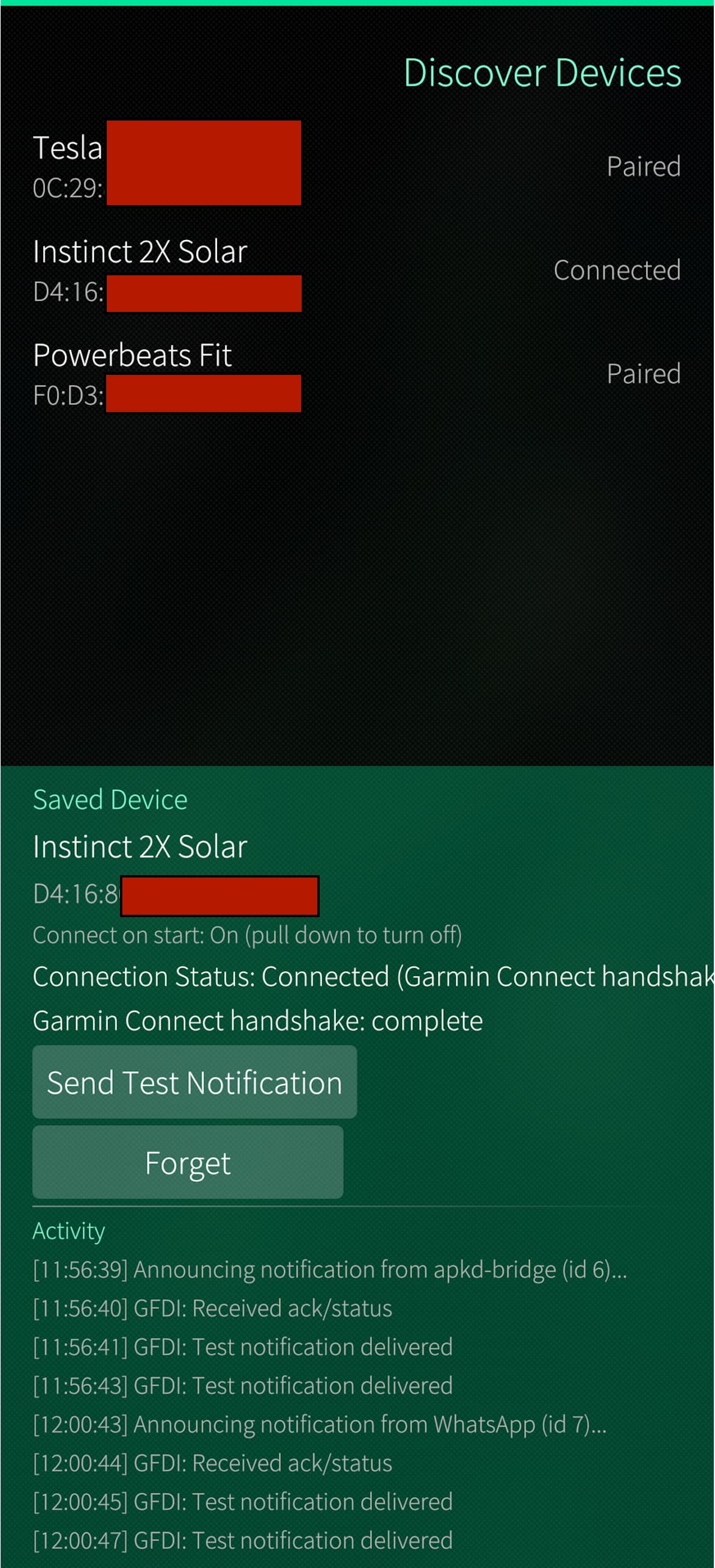

That’s exactly what I did last weekend and what this code is doing (except it’s not running on a device, but on SFOS phone).
The worklow/architecture is as follows:
The daemon binary is installed and listens to all SFOS notifications, when one is there it offers it to the main UI app.
Main UI app maintains bluetooth connection via proprietary, previously reverse-engineered by Gadgetbridge, protocol.
Using that protocol, it sends those previously sniffed notifications to the watch.
Watch thinks the connection is from Garmin Connect app.
Here’s a screenshot of how it looks like when it’s fully working, red stuff is censored parts.
