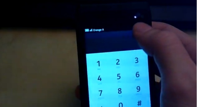

I think there was a patch many years ago for early sfos versions.
Similar to this one:
This problem might be fixed with the notch of the new Jolla phone. They could just implement it such that swiping down right if the notch closes the app while swiping down left if the notch brings down the menu
