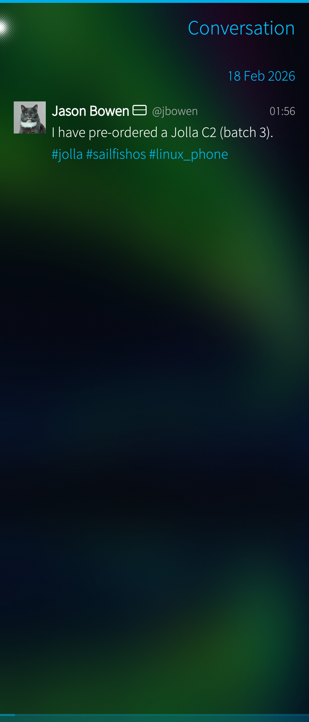

@poetaster do I just remember incorrectly or something, I think there use to be “Reply” option on the pull down menu when looking some toot. Now there is only “Open in Browser” or “Copy Link to Clipboard”. Still seam to able to reply for toots when long pressing toot in my main feed and choosing from there “reply”
If you hold down on a toot you get the context menu with Fav, Boost, Reply, Quote, Bookmark.
If you’re viewing a toot/thread, there is a partially visible reply box at the bottom. This was ‘intended’ but sucks and I’m working on it. There are a number of bugs that crept in with the number of new features :slight_smile:
I don’t know why but when looking toot/thread I can’t find way to activate the partially viaible reply box at the bottom
Edit. But super glad to hear that you are already working on it <3 Love the app :slight_smile:
Just tap on the little green area at the bottom. But, this is why I need to fix it :slight_smile: I’ll either add a handle or just have it be a bit higher. The idea was ‘minimized’ for reading space. But it wasn’t such a good idea.
Not so bad idea in my opinion, but there seems to be no option to revert the maximisation
Ah, might be that screen protector is messing things here. If I tap around ten times from there, from one tap it opens it. So it works, but not just so well maybe with screen protector, Sony Xperia 10III here. Also noticed (don’t know if this is known bug) if I try to follow someone, I can press the follow button multiple times and it shows the follower number dropping everytime I press the follow button. I think that is just visual bug, just FYI in case this wasn’t tracked
I’ll make a ticket! That could be another new one.
