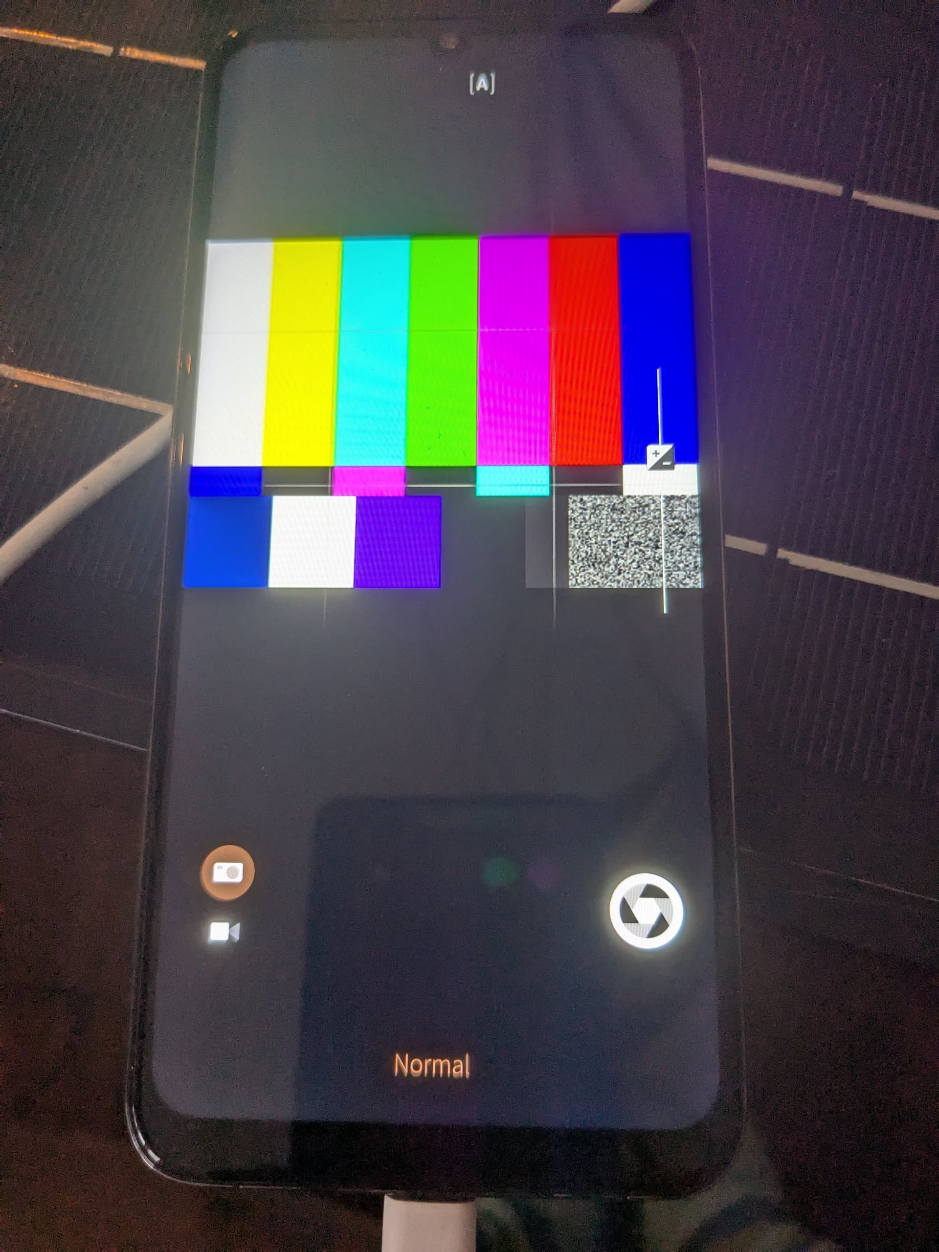

The camera does not work on new C2, is it hardware error or software glitch?
I got my brand new C2 last week, and the setup went OK, but the camera only show a still picture that looks like the test picture from a TV station, that is there is a color bar, and in the right lower part, there is snow (white noise).

Thank you, the tests show that video playback failed, and video playback and vibration also failed, and the camera still shows the same picture, so I think i will return the phone, something is clearly not OK.
This is the picture that is shown.
I’m sorry for that confirmation. Good luck.
Have you done the Front Camera and Back Camera and Flash tests in CSD?
