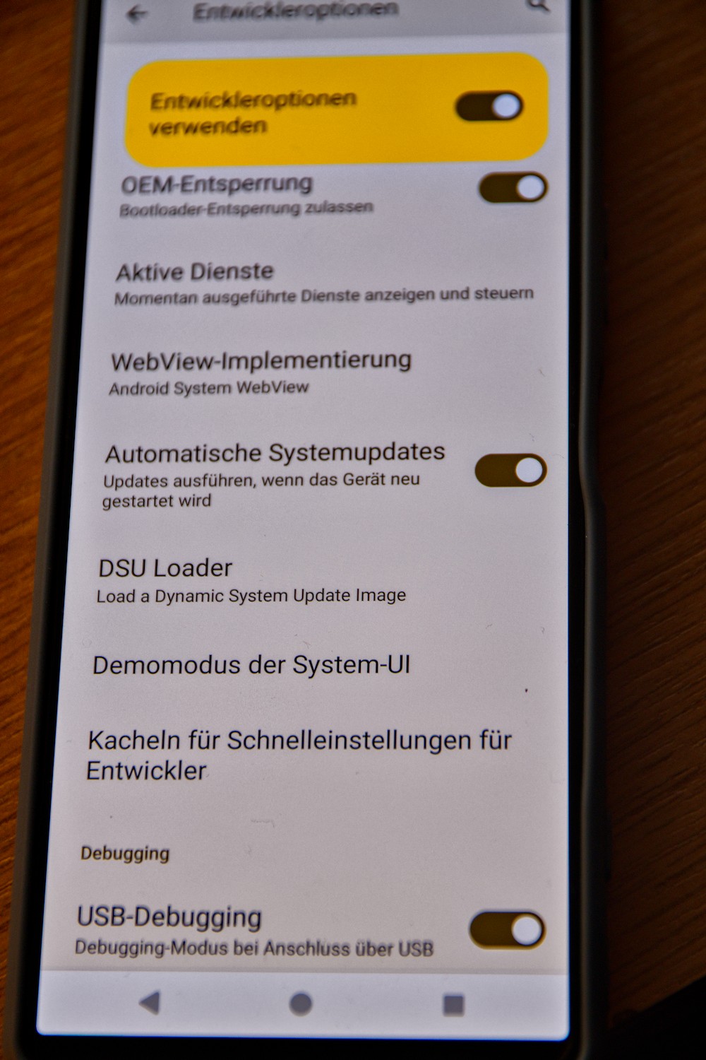

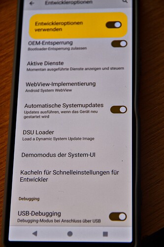

Ok, guys, i think I’m giving up. I’m totally frustrated. I have a

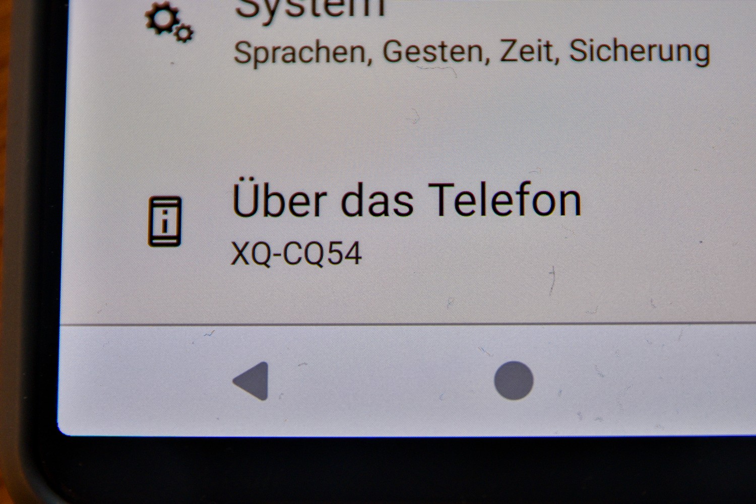

XQ-CQ54 it isn’t a branded one, anyway I’m not able to unlock the bootloader.

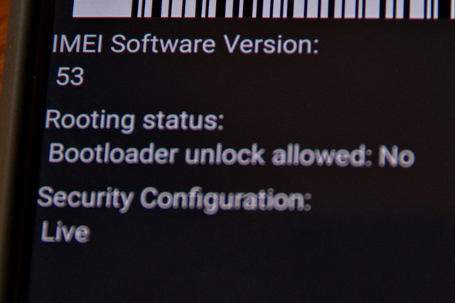

What the heck is this?
Any tips? Despite the shown status I tried it with fastboot and Sony Flash Tool. No success.
Am I doomed? Is it just a gamble to get unlockable phones? Is there a way to force a unlocking?
Maybe it is some customized version of the device (nightmare!!!). In the same way as you’ve got to screenshot with Bootloader unlock allowed: No, look around for Service info, Software info and customization version. With that version try to search for it – maybe it is some special carrier locked version.

Hi, can you plug it into Xperia Companion and check the model? Does it return the correct one (XQ-CQ54) in your case? My best bet is that your 5 IV is a Japanese device that has EU firmware flashed. Forgive me if I’m wrong, but here is my easiest way to detect if the phone can be unlocked and confirm it’s not a carrier-locked Japanese one:
In case one didn’t know, some sellers sell Xperia branded as “global”, but they are actually carrier Japanese phones (DoCoMo/SoftBank/au) flashed with EU/JP unlocked firmware (but only SoftBank/au ones can be crossflashed with EU 54 firmware) - and they are fairly easy to spot. REAL 44/54/62/72 models have a “Do not recycle” logo on the back, along with the “Sony Corporation | model number” text at the bottom of the back glass. Japanese carrier-locked models, in most cases, only have the Xperia logo or that carrier’s logo on the back.
Also 62 models can’t be unlocked - Sony said that on their website.
