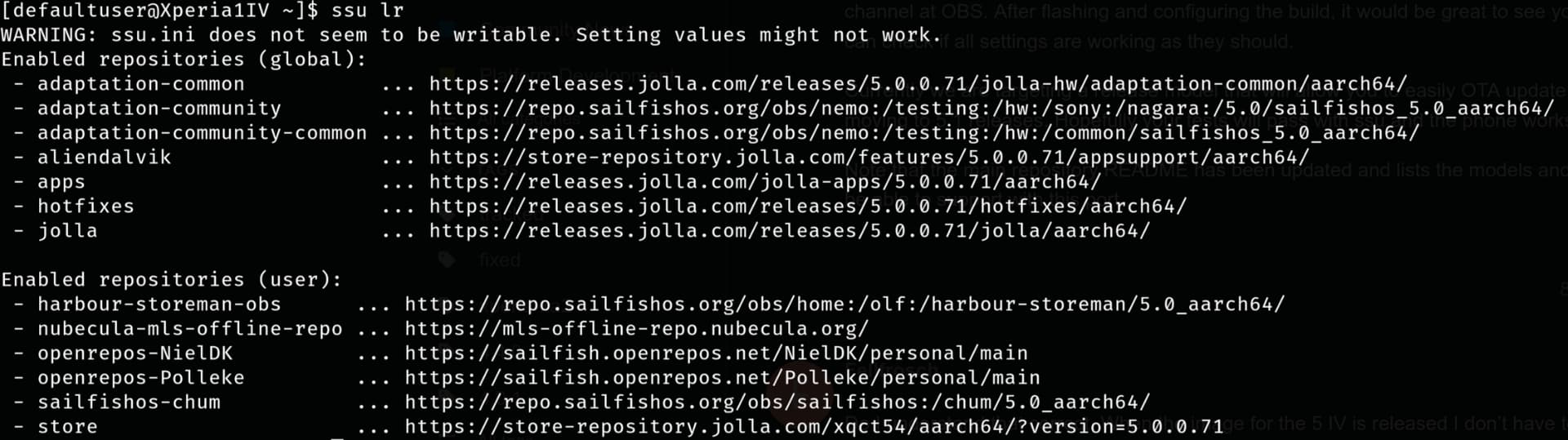

Here is the output of ssu lr (as user):

Please paste it as text. That way we can click and check repos
Okay, but in the evening, as the phone is not with me currently.

[defaultuser@Xperia1IV ~]$ ssu lr
WARNING: ssu.ini does not seem to be writable. Setting values might not work.
Enabled repositories (global):
 - adaptation-common           ... https://releases.jolla.com/releases/5.0.0.71/jolla-hw/adaptation-common/aarch64/
 - adaptation-community        ... https://repo.sailfishos.org/obs/nemo:/testing:/hw:/sony:/nagara:/5.0/sailfishos_5.0_aarch64/
 - adaptation-community-common ... https://repo.sailfishos.org/obs/nemo:/testing:/hw:/common/sailfishos_5.0_aarch64/
 - aliendalvik                 ... https://store-repository.jolla.com/features/5.0.0.71/appsupport/aarch64/
 - apps                        ... https://releases.jolla.com/jolla-apps/5.0.0.71/aarch64/
 - hotfixes                    ... https://releases.jolla.com/releases/5.0.0.71/hotfixes/aarch64/
 - jolla                       ... https://releases.jolla.com/releases/5.0.0.71/jolla/aarch64/
Enabled repositories (user):
 - harbour-storeman-obs      ... https://repo.sailfishos.org/obs/home:/olf:/harbour-storeman/5.0_aarch64/
 - nubecula-mls-offline-repo ... https://mls-offline-repo.nubecula.org/
 - openrepos-NielDK          ... https://sailfish.openrepos.net/NielDK/personal/main
 - openrepos-Polleke         ... https://sailfish.openrepos.net/Polleke/personal/main
 - sailfishos-chum           ... https://repo.sailfishos.org/obs/sailfishos:/chum/5.0_aarch64/
 - store                     ... https://store-repository.jolla.com/xqct54/aarch64/?version=5.0.0.71
thanks! that looks good and should work with OTA updates
