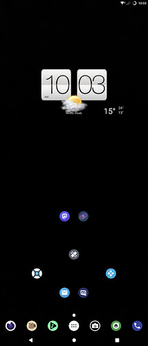

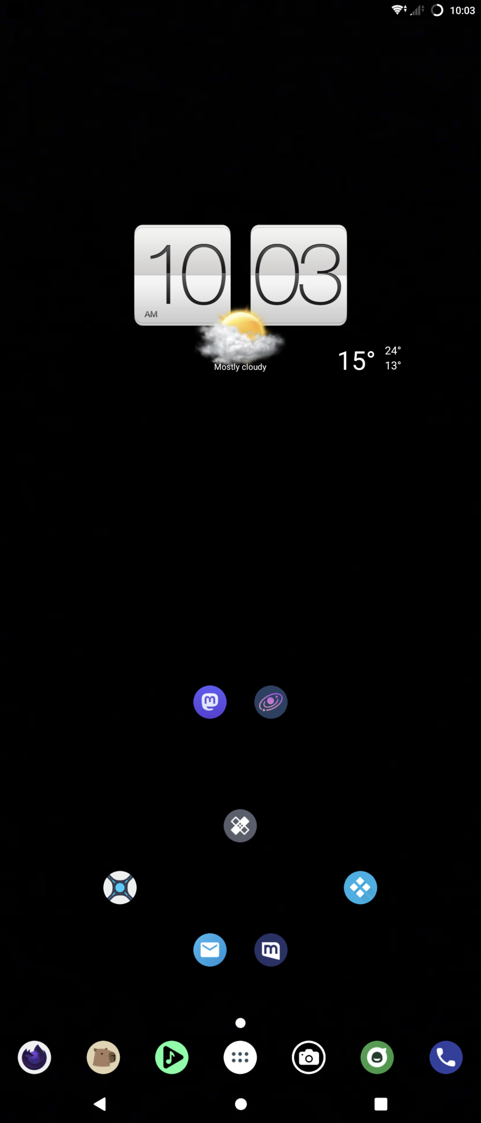

Also, I might as well ask here since I didn’t get a response on IRC. Are there any other non-gesture launchers around for SFOS? Dyspraxia makes it kinda hard to get the vagueries of gestures right, and it’s an unpleasant user experience for me. I much prefer buttons, so much so that I’ve stuck with a specific launcher layout for almost two decades now. Is it feasible to replicate at least the buttons and application drawer on SF, as pictured below?
There isnt any patch to my knowledge to replicate such a layout with buttons, no.
SfOS is inherently a gestures OS.
There isn’t even the concept of alternative “launchers”.
I would have imagined that less precise swipe gestures would be easier than hitting buttons - especially tiny ones like in your screenshot.
But please, one topic per topic.
