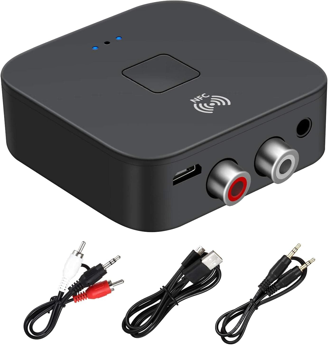

Wrong. There are Bluetooth-to-3,5mm-jack-Adapters out there since years!
I use one of these bad boys on my 1982 Grundig SV1000:
But there are also smaller variants:
And if you are anyway talking about a wired connection, you can just go with a USB-C to 3.5 mm adapter (and from there to whatever analog jack format you like).
