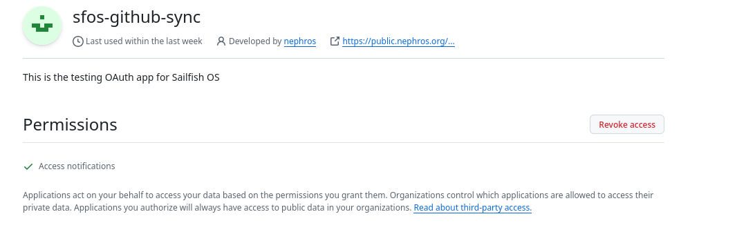

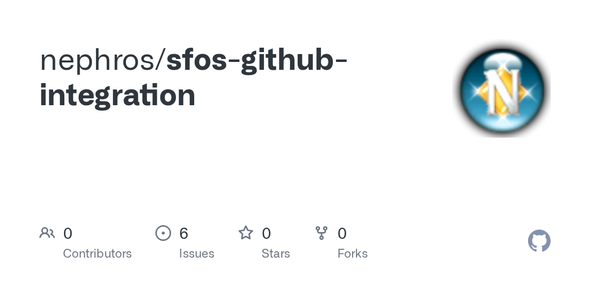

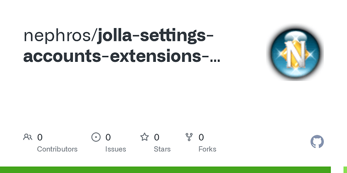

I have at ine point started to work on GitHub integration for SFOS.
It contains account creation (so it’s available through Sailfish.Accounts), and some experimental integration of Github Notifications in Sfos socialcache and Event screen.
Interested developers are invited to have a look and maybe contribute so we can at least get the Accounts stuff into SFOS proper.
It needs rework/rebasing, possibly aligning with the open-sourced Nextcloud account stuff.
Also, due to GitHub requiring an ‘Application’ tied to an account, in the end Jolla would hopefully create and provide that like they do with other services.
I have not touched this stuff for a while but I think the Accounts part should be usable still:

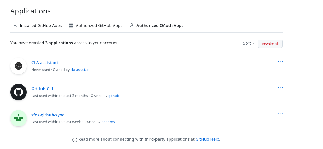

It’s been a while, but yes:
Ah, I finally found it. There is a classic tokens pain you only find if you start creating another thing like an app or oath flow.
